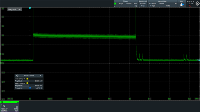

    How long time did CH3/4 into diag state? Kindly capture the CH3/4's output waveform, to see if really anything abnormal happened.
    I checked and its around 0.676s in diag state. Is this expected?
    The AC diag alone takes around 140ms time. Not sure if you counted DC+AC together, could you share your side waveform?

    Ishak
  • Hi Ishak
    Below should be the DC LDG waveform, but it's shape indicates there's fault. Usually S2P or S2G will have such kind of waveform. Could you check your set up?
  • Hello Shadow,
    Shall we connect on call? May be it will solved fast actually DTHE project our customer Daimler is tracking everyday.
    Ishak
  • Hi
      I think you could e-mail contact luisvf@ti.com first, he'll be more convenient to support you with meeting.
