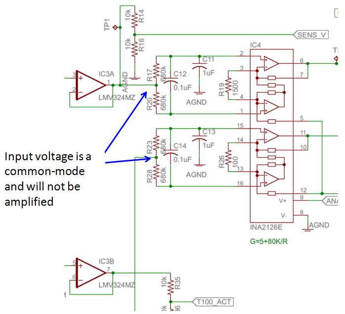

I took great care in laying out the board such that the analog ground and speaker ground are sperate. They meet at the 3V battery terminal. I tried limiting the current of the speaker by using a 100 ohm resistor feeding a 0.33F Supercap and I still see the spikes.  Scematic of speaker circuit and PS attached. Any suggestions are welcome.

    There are a couple things I should point out. First, the input signal to the INA2126 is being applied as a common-mode voltage (same polarity at each input), instrumentation amplifiers are designed specifically to reject common-mode voltages and the INA2126 will not produce an amplified output signal in this configuration:
    Second, are the long blue traces or the areas outlined in dotted blue lines the grounds? I ask because I do not see a connection between the ground areas and the ground pin on P2.  In either case there will be a very large amount of inductance in the ground return path of the INA2126. This will limit the effectiveness of power supply decoupling capacitors and also has the potential to radiate and receive EMI. For a design such as this one with a crowded board that includes both low noise analog and high current PWM,a multilayer board with a continuous ground plane is really preferred (single ground for both analog and digital).

    i am not trying to amplify the signal, but looking for an output when there is a minute changes in the input. C11 and C13 inegrate the input signal and dont change as quickly as the minus input to the INA126. This circuit works as it should. The input to the voltage follower is basically a bridge and the output sits ast 2.5V
     Second yes all the grounds shown on the top left of the schematic are connected, just not shown on the schematic. The traces for grounds are very large and direct almost 1cm wide. The cost on this product prohibits multilayer boards.
