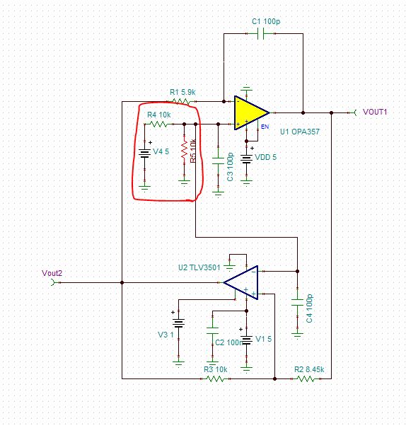

    I have simulated by using voltage divider at (+) input pin of OPA357.
    When just 2.5V of input voltage was used, the output waveform was fine but using voltage divider as below circuit, the distortion of output waveform occured.
    The bigger the value of resistor of voltage divider is, the bigger the distortion of the output waveform is.
    I attached the file that is the simultation result depending on the value of resistor.
    Please refer to attached file and let me know why this distortion occurs.

  • Sammy,
    This is not distortion, capacitor C4 and C3 must be charged up to 2.5V through your resistor divider. At the start of the simulation, the voltage on these capacitors is 0V and the oscillator will not work. The oscillator starts working after the voltage on the capacitors reaches a value large enough that the OPA357 and TLV3501 are not saturated into their supply rails. Of course, the smaller the resistors in the voltage divider the faster capacitor C3 and C4 will charge up.

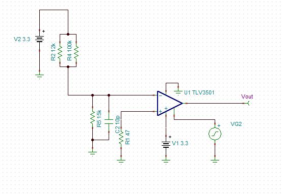

    Additionally, please let me know what resistor of voltage divider(fixed dead time circuit) is better. For example, to make 1.65V of Vref at 3V, 1k || 1k or 10k ||10k.
    I tried to simulate attached circuit by Tina, but in case of 3.3V of VCC and input voltage, I could see the distortion of waveform.
    I would appreciate it if you provide your simulation file or picture of that to check my simulation.

  • Sammy,
    I did see some distortion in the triangle wave due to excessive loading on the comparator output. This was improved by increasing the value of R7 and decreasing the value of the capacitor. Also, in simulation it would appear that the oscillation frequency is lower than expected, most likely due to the propagation delay of the comparator. Please see the resistor values in the attached simulation which gives the correct oscillation frequency and shows proper operation at 3.3V.
    The resistor dividers for the fixed dead time circuit are really only determined by the required accuracy and the amount of power supply current they are able to sacrifice. 10k || 10k wastes less current than 1k || 1k.

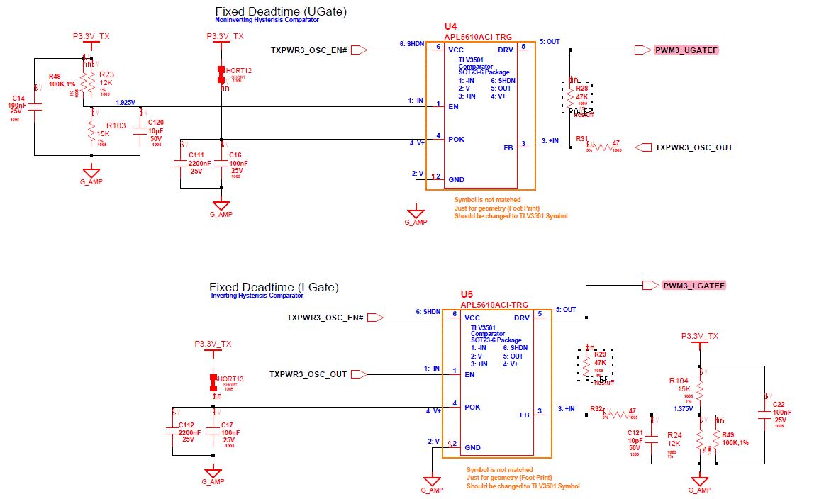

    Hi John,
    I would like to ask shutdown function of TLV3501
    As I have mentioned, Samsung is using TLV3501 to make PWM pulses that put into high side and low side of Gate Driver(LM5113).

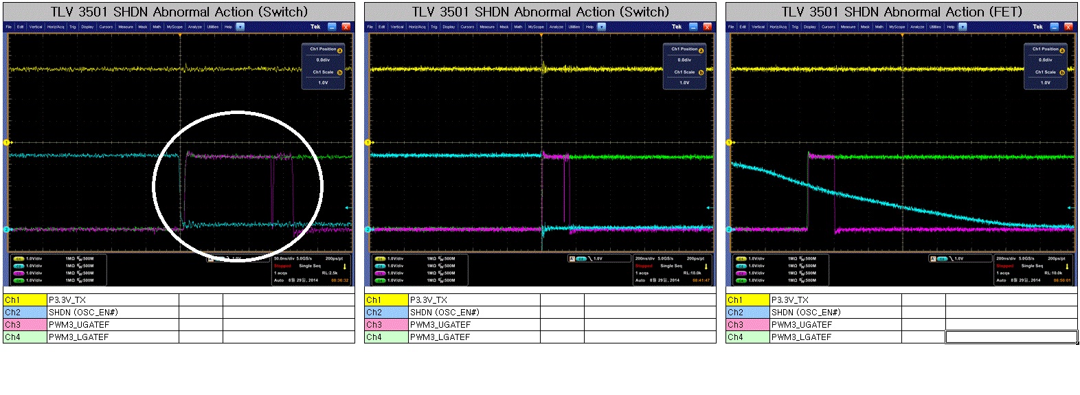

    Under test the board, they found the problem.
    The schematic is below. U gate is for High side and L gate is for Low side. As you know, 6.78MHz triangular waveform put into each input pin. (U gate:(+) input - non inverting comparator, L gate:(-) input - onverting comparator)
    To test the board, they connected input pin to Ground. For your convenience, I attached the circuit configured by Tina.
    For U gate circuit that is non inverting comparator, since reference voltage is always bigger than input signal, the output have to be "Low" in case of that shutdown pin is "Low' (device active state). - Note that input pin is connected to Ground for test.
    However, when shutdown pin is going from "high" to "low", a pulse occured at output. (shutdown pin is connected to 3.3V and then is connected to ground)
    After 3.3V of VCC and reference voltage were connected to device, shutdown function was performed.
    I think that the pulse seem to occur at the level between VH and VL. Otherwise, is there any unvaild time that normal operation is not guaranteed.
    Could you explain why this pulse occur?

  • Hi Sammy,
    The TLV3501 does not appear to have an internal power on reset (POR) circuitry that would assure the output stays low during power up and power down sequences. I reviewed the original design review and there was not mention of POR circuitry. That isn't too surprising because that feature mostly appears in our newer comparators.
    What likely happens internally as the TLV3501 is going from the powered on state into the shutdown mode is the upper output MOSFET momentarily turns on pulling the output high. That ceases as the internal stages become de-biased and that MOSFET shuts down allowing the output to go low again.
    One thing that you might try is adding a load resistance to ground at the TLV3501 output. Something on the order of a kilohm should be adequate. This might help keep the output low during the shutdown phase. It just depends on how much current the TLV3501 can source when going through the shutdown sequence as to whether the output stays low, or moves off of its low.
    Regards, Thomas

  • Hello Sammy,
    Okay, my original understanding of the TLV3501 circuit conditions was correct. Yes, please have Samsung try the pull-down resistor. Let me know if that corrects the problem.
    Regards, Thomas
