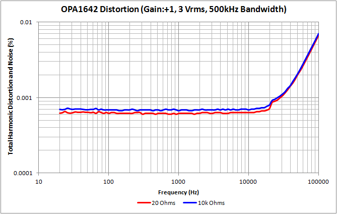

    Because the output impedance of the instrument can vary, there won't be any benefit in selecting resistors to match the source impedances at the two inputs. The distortion produced by mismatched source impedance comes from the varying common-mode capacitance of the op amp with the input common-mode voltage. This is very common in older JFET input op amps such as the TL072, OPA2604, and OPA2134 and has to do with how they are fabricated. I have written an article on this that will be published in the 4th quarter Analog Applications Journal this year. Our newer JFET input op amps do not have this issue, for example the OPA1642 does not require matched source impedances for low distortion and has improved performance over the OPA2134. CMOS op amps are also less suceptible to this effect, so the OPA1652 is another option.

    Thank you for the quick Response. I was actually looking at the OPA1642 before posting, but it too, on page 13 of its data sheet, mentions the same concerns.  So is it still a concern, but less so, or is the data sheet not correct?
    Thanks again for your help.
    JIm
  • The datasheet of the OPA1642 was released before a major improvement was made to its semiconductor process, so in this case the datasheet does not tell the whole story. Here is a plot of the THD+N of the 1642 a source impedance mismatch of 20 ohms and 10k ohms:
