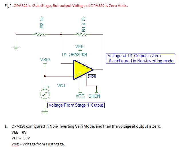

I have configured OPA320 in Non-inverting configuration with double Gain. But i found when i use a gain for OPA320 there is no output voltage. Again if i remove gain and use as buffer, then i am seeing output voltage following input voltage .
Can you help me in overcoming this issue ?

  • Pavan,
    Please provide a circuit schematic of your application since it is impossible to know what you exactly mean by configuration with double gain - picture is worth thousand words (use Insert/Edit Media button above). Also, by no output voltage do you mean the output is zero?  If so, you most likely configured the circuit with a positive feedback so the output collapses on one of its rails.

  • Pavan,
    In your document, you show completely two different circuit configurations:
    In the first circuit (see below), the DC gain is 1, thus applying few macro-volt DC signal at the input will result in the output being saturated at its negative rail.
    The second circuit (see below) has DC gain of G=+5.7 and you should see the correct output voltage as long as you make sure to enable the part (SHDN>2.31V for Vs=3.3V) - see PDS table below.
    Also, make sure that the input voltage is large enough (Vin>~20mV) so the output is driven at least 100mV above the negative rail (within linear output voltage range of OPA320).
    I have simulated the circuit above for Vin=0 and Vin=100mV and it works as it should - see below.
