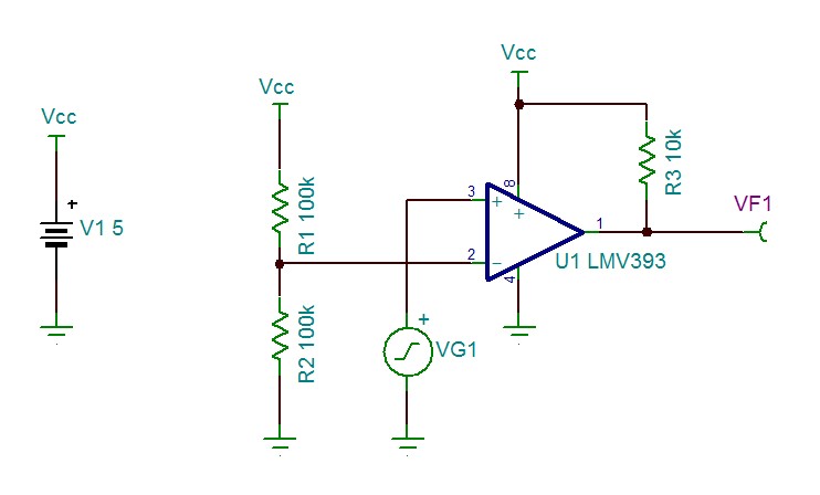

In the Figure 4 and 5 of the datasheet the logic presented is:
IN+ bigger thet IN- => Output Q8 open => OUT 5V
IN- bigger thet IN+ => Output Q8 close => OUT 0V
However, In the Figure 13 the logic presentesd is the oposite:
IN- bigger thet IN+ => Output Q8 open => OUT 5V
IN+ bigger thet IN- => Output Q8 close => OUT 0V
If I refer to the section ; 9.2.1.2 Detailed Design Procedure, we might have the circuit below.
And the simulation with TINA TI gives :
But if we have a look at the figure Figure 13 it's the opposite.
The Figure 13 of the datasheet is it correct or there is something I didn't get?

Hello BMA,
The graph is correct. What is not shown too well in the the graph is the input "overdrive" voltage. "Overdrive" voltage (+5mV, +20mV or +100mV) is the "extra" voltage above the threshold trip point (0V in the graph). The more overdrive voltage, the faster the response - which is what the graph is showing.
The input signal starts at -100mV, but it *stops* at +5mV, or +20mV, or +100mV. So at that point, the negative input is *above* the positive input, which would make the output go low.
In your simulation, you have the inputs backwards. In the graph, the pulse is going into the negative input, and the reference voltage (GND) is going into the positive input. Reverse the inputs and it will then match the graph :^)
Hello.
The Figure 13 of the datasheet (document: SNOSBJ6F –OCTOBER 1999–REVISED DECEMBER 2014) is incorrect.
The correct Comparator Response Figure should be something like this:
The Correct Output Logic is:
IN+ bigger that IN- => Output Q8 open => OUT 5V
IN- bigger that IN+ => Output Q8 close => OUT 0V
