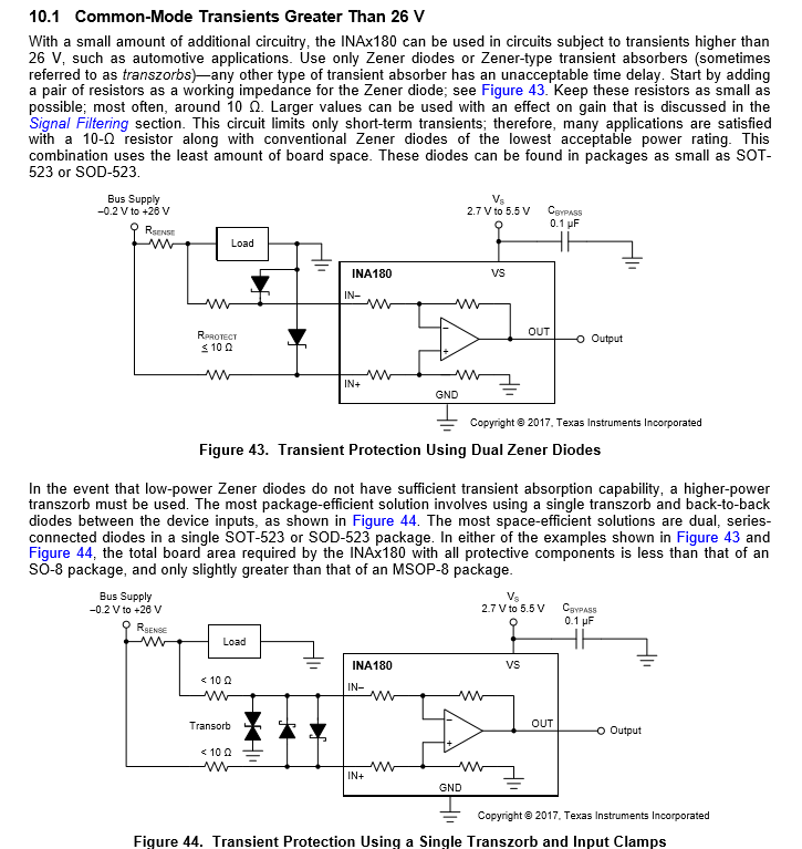

Under a short circuit, there is the possibility that the whole supply voltage can become present across Rs, which could potentially exceed the maximum rating of the INA193. Differentially, that is +/-18V. Its also note considering any parasitic inductance on the circuit that can cause a voltage overshoot when the mosfet opens the circuit.
The INA180 datasheet specs some guidelines you might find useful when designing some protection circuit.

I doubt that the we have exceeded the +/-18V input voltage limit as we did not do the short fully as only increased the current to 1.5Amp by reducing the load resitor to <33ohm.
I am attaching the circuit of our application, as per our requirment we are supplying 28V DC to the external load which is currenly a resitive load of 33ohm@28V(having 1uf cap. In parallel to it), and in actual field it will be indutive load.
