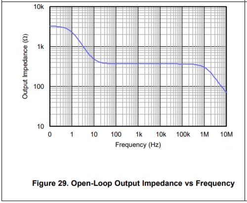

When OPA197 is used as a general DC non-inverting amplifier with a power supply voltage of 24 V (single power supply)
What is the minimum output impedance?

    The OPA197 open-loop output impedance Zo is approximately 3 kΩ, at very low frequencies and DC according to the datasheet Fig. 29 graph shown below. That is a typical value and we don't provide minimum or maximum Zo values, but even if it varies somewhat there is little effect on the closed-loop output impedance Zout.
    When the op amp loop is closed in the non-inverting amplifier you propose Zout becomes very, very low compared to the Zo value. Zout is related to Zo by the following relationship:
    Zout = Zo / (1 + AOLβ)
    where: AOL is the open-loop gain, and β = Ri /(Ri + Rf)
    Ri = input resistance, Rf = feedback resistance
    For a unity gain buffer, Rf = 0 and Ri  = ∞ and β = 1, and using Zo = 3 kΩ at DC,and Aol = 120 dB (106 V/V) from the datasheet Electrical Characteristics table:
    Zout = 3000 Ω / ( 1 + 106 V/V) = 0.003
    Thus, the closed-loop output impedance Zout is very, very low. Changing Zo or Aol still results in similarly low Zout.
    The supply voltage level has minimal effect on Zo.
    Regards, Thomas
