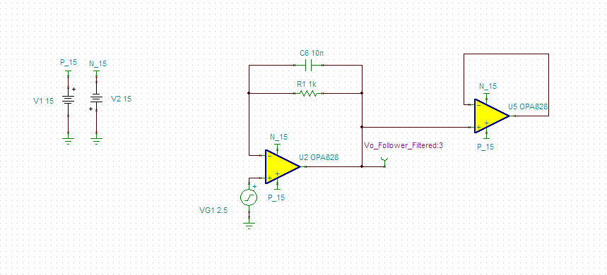

    I have also downloaded and tested the TINA model of the OPA828. As you'll see it in the attached file, the OPA828 as a follower without a resistor and capacitor feedback seems just fine with a 0-5 V square signal; I'm not sure how in reality it would do.
    I've also done the same follower, but this time with the resistor and capacitor in the feedback. I've tried capacitor values from 5pF, and it seems that a 10nF ( !) capacitor is the best one. I'm dubious of a so large feedback capacitor and would like to ask how much should I trust this value since I'm using many times this circuit.

    I think I have an explanation for why such a large capacitor is required across the feedback resistor in the buffer case. To begin, I started from your TINA schematic, but replaced the fixed load capacitor with an additional OPA828 instance, as shown. In some cases (especially op amps with anti-parallel diodes between their inputs) this can help to catch unusual transient behaviors early in a design.
    The feedback loop for U2 in this circuit can be redrawn as:
    This gives rise to the following feedback equation:
    With a zero set by the feedback resistor and feedback capacitor, and a pole set by the feedback resistor and combined feedback and input capacitance.

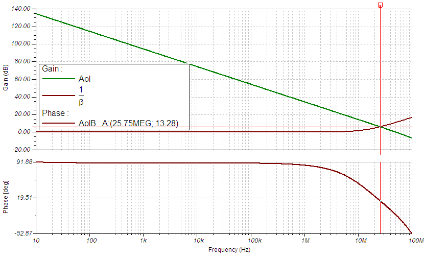

    With no feedback capacitor, we get a first-order pole around 14MHz with no zero.
    I built a stability test circuit for this in TINA:
    Running an AC simulation gives the following curves:
    One guideline we use for stability is rate of closure between 1/B (reciprocal of feedback gain) and the amplifier’s loaded open loop gain (Aol). A 20dB/decade rate of closure is typically stable while a 40dB/decade rate of closure is typically unstable.
    In this case, Aol decreases at approximately -20dB per decade while 1/B begins to slope upwards at ~14MHz (eventually reaching to a slope of +20dB/decade). By inspection, this gives a rate of closure somewhere near 40dB/decade, which is likely to be marginally stable at best. This is also confirmed by the phase margin of ~13 degrees.

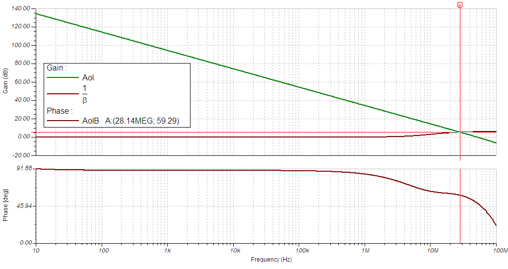

    Adding increasing amounts of feedback capacitance begins to decrease the rate of closure by shifting the pole frequency lower and adding a zero above it, as can be seen in the plot for the same circuit with a 10pF feedback capacitor:
    With 10pF, the rate of closure is now closer to 20dB/decade, with an increase in phase margin to 59.29 degrees.
