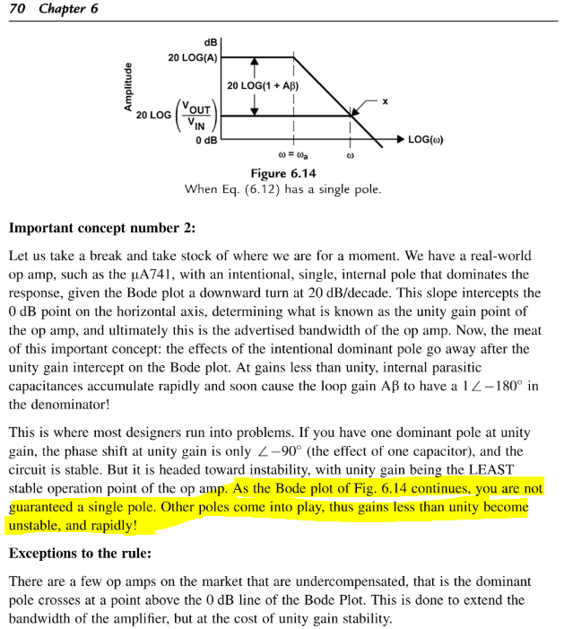

Hello all,
my question is closely related to https://e2e.ti.com/support/amplifiers/f/14/t/177561
The issue there was to use an operational amplifier as attenuator (e.g., to convert an input voltage from 0..10 V to 0..2.5 V). As solution, a voltage divider to bring down the input voltage followed by a (unity-gain) buffer was suggested. This seems in line with what the book "Op Amps for Everyone" (by Carter, Mancini) suggests. The book explicitly warns not to use an inverting opamp as attenuator:
However, I've seen this configuration (0 < |G| < 1) suggested several times (e.g., on electronics stackexchange here). Additionally, I've read discussions where people contest Mancini's statement. They are saying that a non-inverting gain of 1 is the worst-case for op amp feedback stability, which is equivalent to an inverting gain of zero. They conclude that if the OpAmp is specified to be stable at unity-gain buffer configuration, it should be stable at less than unity gain in an inverting configuration, too.
Coming back to the original issue, what's wrong with this solution to the question (except that the output is "inverted"), using an inverting OpAmp as attenuator:
This is the link to the simulation.
Thanks!

  • Hi Kai,
    kai klaas69 said:
    you omit the crucial point of Ron Mancini's explanation, that the discussed OPAmp is only "gain of ten" stable! ...
    To me, Rom Mancini's advice does not read as it is limited to the discussed OpAmp. Rather it sounds like a general advice for OpAmp circuit design.
    This understanding seems to be supported by the discussion in his book in the chapter about OpAmp theory:  it asserts that in general "gains less than unity become unstable".
    I have to say that I find the highlighted statement inconsistent with the claim "unity gain is being the LEAST stable operation point of the op amp".
    I don't know what your circuit shall do, but the -input of OPAmp will sit on a +2V offset. So, the input signal current will not flow into virtual ground (0V) but into a virtual +2V potential. Is this what you want?
    It should convert the input voltage range 0..10V to the output voltage range 2.5 .. 0 V.  That's what the circuit is doing according to the simulation. Why do you say that the -input "sit on a +2V offset" when the +2V bias is connected to the +input of the OpAmp?
    Thanks.
    Dan
