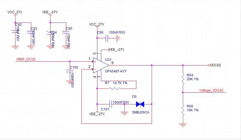

V+=27V,V-=-27V,Vin=+5V,A=1,  when the ES pin connected v-, the output can't be disable and the value is -8.8V,why ?
  • This is the schematic.

    A properly functioning OPA548 should go into output disable mode when the E/S pin is connected to V-. I do not find anything in your schematic that would explain why that is not happening.
    Do you have the heatsink that the OPA548 package tab is attached to floating (not connected to any potential), or connected to V-? If the package tab is grounded instead of floated or connected to V-, that would result in improper operation and possibly device damage. See datasheet Section 11.1.2, Amplifier Mounting, for more information.

    OPA548 didn't go into output disable mode and the output value is -8.8V when  E/S pin is connected to V- and R64/R66 didn't connected;
    but OPA548 output value is -0.1V when E/S pin is connected to V- and output load is 30Ω. This is like we need discharge path.
