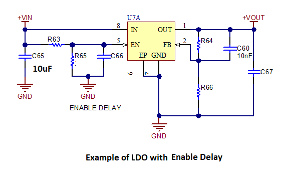

  • Hi Amauri,
    In the past, while working on a different system solution, involving a DC-DC converter on an application where the input supply current was very limited, I had issues on start-up due to the in-rush current required by a DC-DC converter at start-up.  The in-rush current required by that DC-DC converter at start-up was higher than the expected current consumption once the device was powered up.  On that particular case, I was able to work around the problem by powering the supply in stages, and also controlling the ramp-up rate of the DC-DC converter.  In that particular design, I used the enable pin of an LDO regulator with a voltage divider and RC filter to create a delay.
    Since in your experiment, the TPS60400 supply works well once the XTR117 regulator is powered-up, one possible solution is to add a delay on the +2.5V/-2.5V supply.
    One possibility is to modify the design using a +2.5-V LDO that incorporates an enable pin, with a similar circuit as shown below.  This would allow for the XTR117 regulator voltage to completely ramp-up first, where the bypass capacitor at the XTR117 regulator will be fully charged to 5-V first, harvesting enough energy to power up the rest of the supplies, and after a  ~10s -100s of millisecond delay, the RC filter on the LDO enable pin will charge up to the require threshold, and power-up the +2.5V LDO and -2.5V charge pump.  The voltage divider values and capacitor value on the enable pin have to be designed to ensure that the enable pin always reaches the minimum required threshold  of the enable pin after a desired delay.  Below is a link to an application note discuss this topic.  Also, below there is an example of a regulator with voltage divider and capacitor on the enable to create a delay.  Alternatively, you could also consider using a watchdog timer device to program a delay on the enable pin of the LDO.  Please also ensure to use the TVS diodes (or zener) on the +/-2.5V supplies as previously discussed.
    http://www.ti.com/lit/an/slyt730/slyt730.pdf
    The Power Management application engineers may have good suggestions for LDOs or power supplies to be used on your XTR117 design. Consider submitting a query on the forum below.
    https://e2e.ti.com/support/power-management/
    Thank you and Regards,
    Luis
  • Hi Luis,
    Today I was thinking to do exactly what you are suggesting me now, that is, power up the vary stages in sequence using a delay between them. I was not sure that will give me a good result but when I just hear from you about your past experiences with similiar circuits I began to believe this suggestion will solve my problem. In fact I already have got a voltage regulator with an enable pin to make this test. The result was positive. The circuit is working perfectly. Now I have only to optimize the value of RC circuit to get the minor delay.
    Many, many, many thanks Luis.
    Amauri
