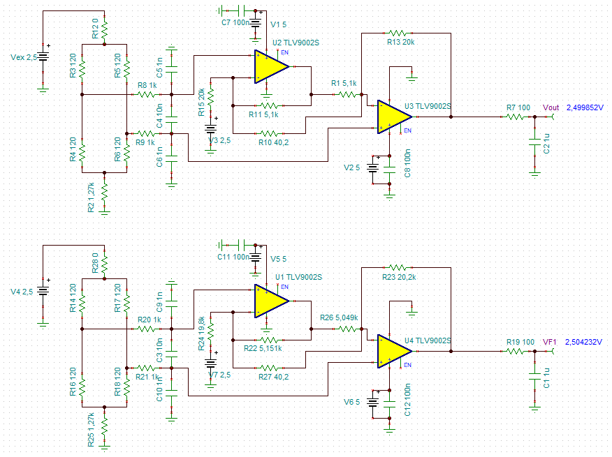

I have considered TLV9004 amplifier circuit to be used for amplifying the strain gauge bridge output and i am referring to application note "SBOA247"
This circuit i simulated in TINA-TI and it is working as described .
Is any practical board/eval board developed with this configuration ?
Since it involves uV/mV signal amplification (strain gauge ) and practical limitation involved in 2 opamp instrumentation amplifier explained in the application not SBOA247 ?

Hi Vasu,
can you post your simulation file?
If your input signal is very low, I would recommend the use of an ultra low input offset voltage OPAmp.
Kai
Hi Vasu,
The DUAL-DIYAMP-EVM has a 2 op amp instrumentation amplifier circuit configuration that can be used with the TLV9002 (dual channel version of the TLV9004).
Some practical limitations would be related to the error sources of the amplifier. You wouldn't want to choose a high noise amplifier because the noise of the amplifier would dominate the signal you are trying to measure. Offset voltage errors of the amplifier can also effect the performance. Offset voltage will add or subtract to the signal you are trying to measure. I recommend watching our TI Precision Lab Videos. Specifically, the videos on noise and offset voltage/input bias current will go into more detail about what I mentioned above.
Lastly, PCB layout can also effect the measurement accuracy. Improper PCB layout can introduce errors and additional noise into your system. I recommend taking a look at "How to layout a PCB for an instrumentation amplifier" and "The basics: How to layout a PCB for an op amp" for information on recommended PCB layout practices.

Hi Vasu,
The design seems to function like I would expect. As I change the resistor values in the bridge the output voltage changes. Is there anything else you would like us to check?

Hello Team,
Thanks for your valuable inputs.
Yes, we have considered 1% tolerance .
We also considering to use of 3 opamp INA . Attached is the circuit.
Hi Vasu,
you still need very low input offset OPAmps with low drift. And you still need very precises resistors. I would go for +/-0.1% resistors.
