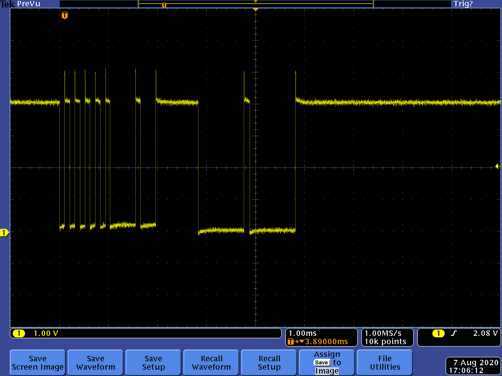

  • Hello Raghavendra,
    The only unexpected behavior is that the response does not reach zero level and is around ~0.8V for a zero bit at the PRG pin output.  It is strange that the behavior is systematically occurring on all devices.  One thing that comes to mind is a grounding issue, or GND voltage differential from the controller GND to the PGA309 GND connection.  When you captured the oscilloscope plots above, did you place the oscilloscope probe right at the PRG pin 12 and right at pin 11 (GND D) of the PGA309 device, with the oscilloscope probes making direct contact with the pins of the PGA309 device?
    Below is a plot of the observed PRG pin behavior on the PGA309EVM.  I placed the oscilloscope probe on the PGA309 side, connected directly to pin11 and pin 12 of the PGA309.  When looking at the difference between the zero level from the controller and PGA309 PRG output low level response, the PRG VOL level is close to zero volts and the difference in low level between the controller and PGA309 is less than 200mV. Per the datasheet, the maximum output low level VOL for the PRG pin is 0.4V; and the PGA309EVM produces a low level below this voltage on the PGA309EVM.  Please see below.
    Thank you and Regards,
    Luis
  • Hello Luis,
    Even I tried communicate with the same units through the TI PGA309EVM and the waveform was as expected.
    I am yet to conduct same testing on those devices failed to communicate  at 125C. But seems like the issue is related to the 5V TTL USB convertor.
