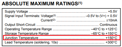

Which INAxxx device that is the closet match to INA326 use in the reference design for RTD (TIDU 969) ?. The INA device will be used in environment of 200C operating temperature. Thank you.

    Can you explain what do you mean by 200C operating temperature? Do you mean that RTD will measure the changes in temperature up to 200C? or Do you mean that INAxxx IC will operate at 200C temperature environment.
    Our max. junction temperature of all INAxxx is rated at 150C. If the operating environment is actually 200C, you have to use cooling block or other means to cool the entire circuit at approx. 80C.

    Currently i am designing a circuit to measure RTD value. However the circuit board is expose to 200C temperature which means that i need a op amp that can operate up to 200C operating temperature. In the reference design (TIDU969) it uses INA326 (but its operating temperature is only 80C max), and when i replaced it with INA333-HT it does not work as well as INA326, such as the gain is setting can never reach what it is stated in the datasheet. Perhaps i am missing something in the design that you can advice ?. Thanks.

    Here is the issues: TIDU969 schematic shown that the RTD to voltage reference design with Gain = 2(698k/2k)=698 V/V, see the image below. The part is not designed to operate at high temperature. Max. operating temperature is probably around 100C in the reference design, if properly cooling is taken place.
    With INA333-HT, the part may operate at ambient temperature at 200C, but the circuit gain has to be greater than > 100 V/V, see note 7 in the datasheet. If you implement the same circuit as TIDU969, what are other components ratings on the PCB board? The junction temperature of INA333 is rated 210C, and the application is operating at 200C, there is very little thermal margin for the part to operate properly. You need to find a way to cool the part in some ways.
