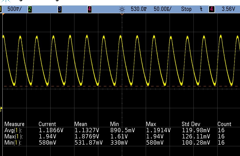

Ian,
The customer has a non-isolated 100nF cap on the output of the INA199. This is 100x the maximum capacitance allowable by the device:
This is most likely the cause of the oscillations. I would advise the customer either remove this capacitor, or reduce the magnitude to less than 1nF, and they should see improvement in the measurement.
Hi Guys,
We take away output capacitor,
Change output capacitor to 1nF,
Others information, the waveform will only DC if I using external power supply to INA199 supply voltage.
But real application power will not so clear as power supply.
Can I say above waveform is correct in real application?
Thanks, Ian.
Ian, would it be possible to get scope shots of the output as well as the corresponding input that is leading to this? If the customer can, I'd like them to probe directly at the IN+ and IN- pins, not at the shunt.
Also, can the customer share if there is anything else connected downstream on the output? What else does 'CSM' interface with on the board?
