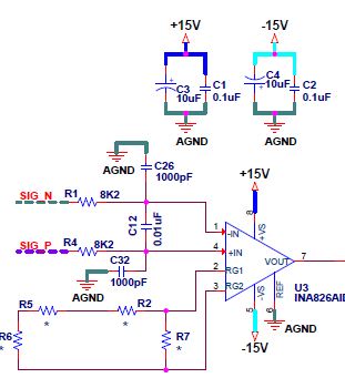

    I have assembled around 40 Pcb boards. In 40 PCB boards it found that 23 boards are working properly. In remaining 17 boards each board has different issue like gradual decrease in the output, some boards are always in the saturation etc.
    I suspected the PCB Quality and Assembled  AD8421 in the same place and all 17 boards are working fine. please find the attached schematic. I have assembled R2 0E, R5 220E, R6 12E, R7 open. This is calculated for the gain of 213 where my input is 12mV and output is 2.56V.
    One more point is the supply provided to instrumentation amplifier is from Dual output DC-DC converter.

  • Hi Tarun,
    The Rg of the circuit is 232 Ohm. The Gain = 1 + 49.4kohm/232 = 213.93.In order to saturate the INA826, the differential input (V+in - V-in) delta has to be above 70mV (15V/213.93 = 70.12mV).
    As Kai suggested, I would take a look at the analog front end of wheatstone bridge including the excitation Vref voltage.
    1. how stable is the excitation reference voltage for the weight bridge sensor.
    2. What is ripple voltage on your excitation reference voltage? The differential filter cutoff frequency is approx 440Hz.
    3. Assume that pin6 of INA826 is connected to stable AGND.
    4. If you use AC/DC or DC/DC regulators, please filter out switching noise properly. Please use low ESR ceramic capacitors to remove high frequency switching noises at the output of voltage regulators.

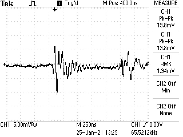

    1. The excitation reference voltage provided to the weigh Bridge is Stable. I have measured the ripple and attached the screen shots.
    2. In my schematic the REF Pin connected to Stable Analog Ground.
    3. Iam drawing my power supply from 230V to 24V using Tiny Switch and then Using DC-Dc converter for the Dual supply of 15V. I have measured the ripple of the both the supplies and attached the scope shots.
    Tarun
    Exicitation Scope Shots
    +15V Scope Shot
    -15V Scope Shots
  • Hi Tarun,
    hhm, that's way too noisy for my taste :-(
    All supply voltages must be clean, stable and noisefree! I would recommend the add of supply voltage filtering :-)
    The use of switchers to generate the supply voltages might not be the best idea here, because your signal is ultra low and you must amplify ultra highly. This will only work with sophisticated and optimized low pass filtering by using Pi-filters.

  • Hi Tarun,
    I agree with Kai's comments.
    Your input signals from Wheatstone bridge is only up to 12mV for nominal operation. Your excitation Vref input has voltage ripple from approx. +6mV to -11mV. +15Vdc has voltage ripple from +15mV to -12mV and -15Vdc has voltage ripple from +7mV to -12mV. These ripple noise figures are too much for the weight measurement application.
    Kai has suggested some power regulator filtering method in another forum, see the link below. I think that your +/-15V power rails may need to help with such regulation. This is capacitance multiplier to filter out voltage ripple method. 2.2kOhm and 2.2uf capacitor are LPF filter and T1 and T2 are series regulators (you may also use 2N2222 or 2N3906 or other BJTs). It will do wonders to remove most of your power supply noises. If the output voltages are still noisy after the circuit is implemented, increase 2.2uf  to 10uf to filter out additional noises. As it is configured, the LPF cutoff frequency is at approx. 33Hz.
    The method will work well for INA826 circuit only due to low current consumption requirements. If you need to drive higher current with the circuit, then you may have to beef up the series transistor to handle to higher power dissipation.
    BTW, you will need ultra low noise and stable Vref excitation voltage for the Wheatstone bridge circuit. The absolute values of +/-15Vdc or Vref are not so critical, but it has to be stable, since INA826 is only measuring the difference of Wheatstone weight sensor at its input. If you are able to fix the voltage ripple to INA826 part, most of the observed issues as you stated above should go away.
