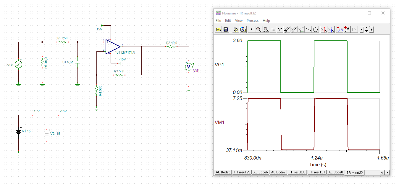

I am using LM7171 as a clock distributor in my circuit. It is working at +15V and -15V the output from this Opamp is going to the clock input pin of my ASIC.
when the clock amplitude is 3.6V ,I am seeing a glitching at the output.I/P CLK frequency is 2.4Mhz
May I know where I went wrong. Please find the attached TINA simulation file.

Well you have a 1nsec input edge, that is likely putting the LM7171 into slew limiting which will cause that overshoot,
Well it is not letting me insert the snip, but if you slow the edge down in sim (or with an RC circuit into the V+ input), the overshoot should go away.
try again, I was not logged in,
here is a 5nsec transition - notice the overshoot is gone

I put a capacitor of value 1.5pF across the feedback resistor and glitches were gone. I did it via trial and error.
Could you please tell me how to calculate the compensation capacitor value using maths.
HARI
I actually do not prefer the feedback cap as that shapes the noise gain to 1 at higher F sometimes moving to a lower phase margin condition, a simple RC into the input V+ pin is what I prefer. And essentially, once you have a small signal frequency response, you are trying to assess if the peak dV/dT on the output might exceed the available slew rate for whatever part you are using. And, you might want to consider a current feedback solution as they naturally have much higher slew rate.

To put it simply, the 'peak dV/dt' is the maximum change in voltage with respect to time, or the 'slope' of the voltage signal. The slew rate is just what we call this when talking about what the amplifier is capable of delivering. If you need the output to change faster, (larger slope/slew) then you could choose a part with a faster response (higher slew rate). Current feedback amplifiers are an option, although they can potentially be trickier to implement if you are not familiar with their characteristics. The solution presented here, the 'RC' network, is simply a low-pass filter that will limit the input slope so that it does not exceed what the amplifier can deliver. This is also sometimes called increasing the rise-time or the time constant of the input signal. For a more in-depth look at this issue and why exceeding the available slew rate will cause the device to behave undesirably, please see TI Precision Labs - Op Amps: Slew Rate Introduction | TI.com Video

This is way more than you need for passing a clock around - you might also consider the output interface, if you are driving an ASIC, your really only need a small series R to isolate its input C, not that 50ohm shunt if you are not driving through a cable.
