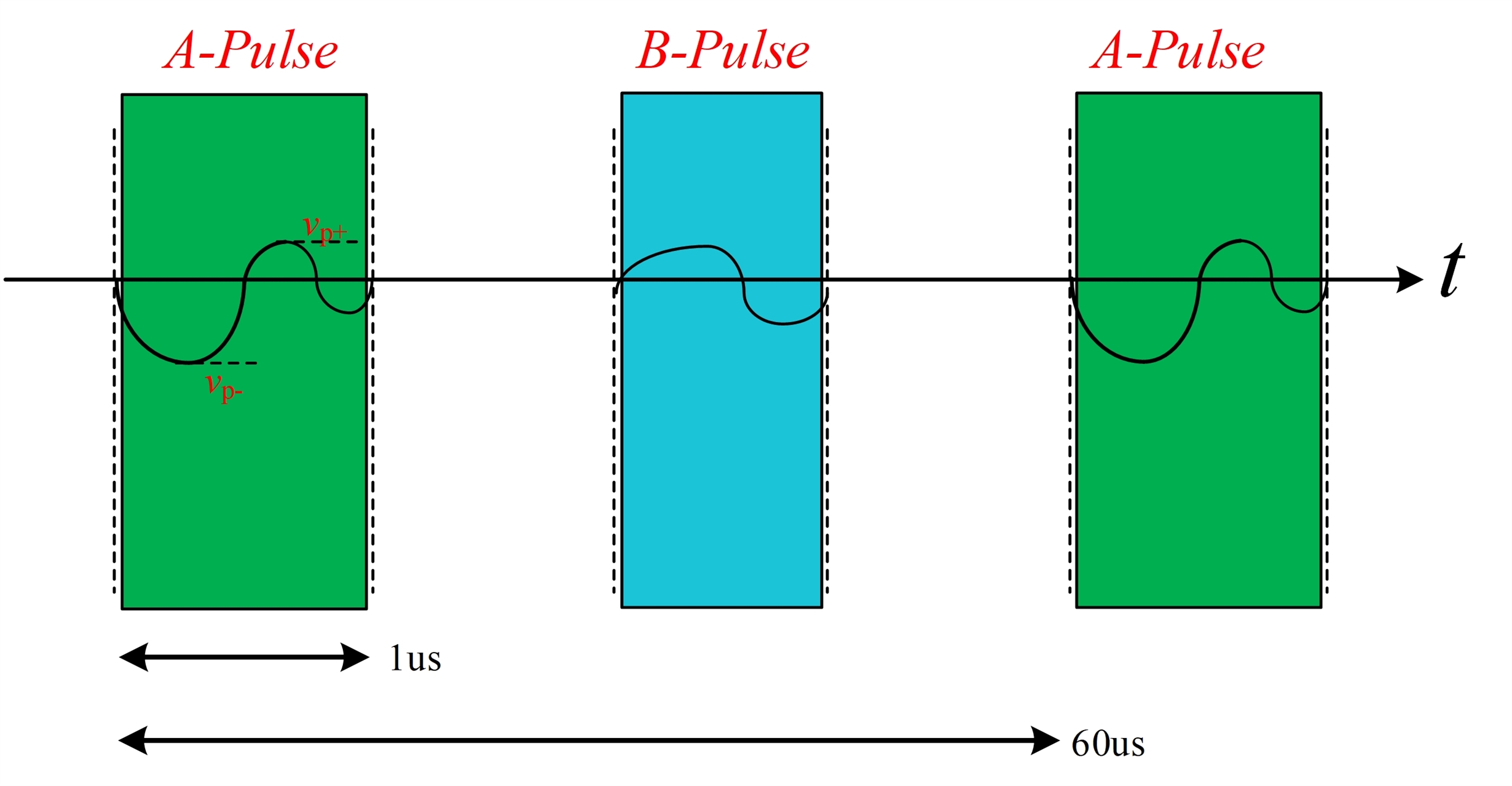

    The input signal vE is periodic as the figure below. A-pulse and B-pulse occurs at vE in turn. The shapes of A- and B-pulse are approximations.
    A-pulse should be fed to the integrator and B-pulse should be isolated by subcircuit A from the integrator.
    As can be seen from the figure, the period is 60us and A-pulse lasts for more than 1us.
    vp+ in the figure is no larger than 30V and vp- is no lower than -30V. Peak values for B-pulse are also within -30V and +30V.

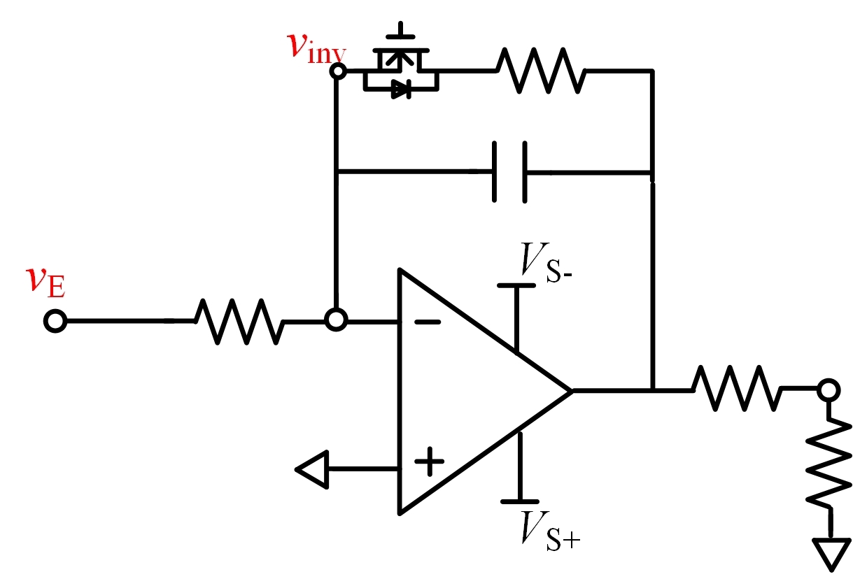

    Actually, input signal vE is the induced voltage across parasitic inductance in power semiconductors and its magnitude is decided by the load current flowing.
    I've come up with a simpler solution myself as the figure below.
    I move the subcircuit away and introduce reset MOS for the integration capacitor. A short time ahead of A-pulse, I'll turn off the mos and the integrator works. Short time after B-pulse, I'll turn on the mos and the integrator output will be reset. If the output is positive, output be discharged by MOS channel. If negative, the discharding will be via body diode in the MOS. Since I only care about the integration output after A-pulse starts and before B-pulse begins, the reset before A-pulse can avoid wrong accumulation from cycle to cycle.
    I paln to use TI's http://www.ti.com/cn/lit/ds/symlink/ucc20225a-q1.pdf to drive the small MOS and provide isolated power for the chip and MOS, with vinv as the ground level.

  • Hello Yatao,
    Here is my suggestion: convert the voltage into current at Ve; using current mirror circuit to duplicate the input current at point P, then integrate the duplicated current. This may create isolation from Ve.
    Take a look at ACF2101 integrator, it may be able to handle your application.
    Raymond
  • Dear Raymond,
    Thx for your advice.
    I'll take a look at the chip.
    Besides, the solution I propose can also work, I think ^ ^
