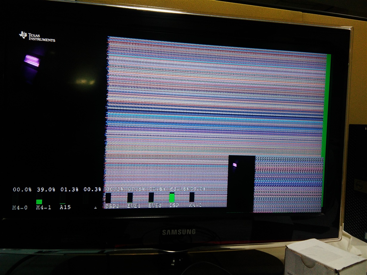

I am trying to bring up AR0220 sensor on my TDA2p. I have configured ser, deser. I am able to generate pattern from ser and deser. I am able to write in sensor's register.
1) I am not getting any data from sensor.
Attached my sensor configurations.

  • Hello Brijesh,
    Yes we did try that by commenting the errorCb function call and we got below image on HDMI display.
    Abhay
  • Abhay,
    ok, at least, something started showing up.
    The artifacts on the other half of the screen is because of the CRC/ECC issues.
    Can you try reducing back channel frequency of SERDES link?
    Rgds,
    Brijesh
