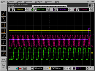

  • Thank you, Mr.Frost.
    I measured the waveform with an oscilloscope.
    The state of the right channel is the same.
    • zero output
    <I2S-24bit>
    <I2S-32bit>
      • sine output(left channel)
      <I2S-24bit>
      <I2S-32bit>
        •  0x7FFF-8000 output. (Left channel)
        <I2S-24bit>
        <I2S-32bit>
        CH1:current to voltage converter output
        CH2:DATA
        CH3:LRCK
        CH4:BCK
        The invalid data was 0x5555-5555.(Invalid data is added to investigate the cause.)
        I'm sorry for making a mistake.
        There is no reason to use BCK=128xfs.
        Of course, it is possible to use it with BCK=64xfs.
        But before that, I want to figure out the cause.
        Best regard.
      • Hi Ootsuka-san,
        Is it possible that your I2S host is left shifting the data when you set the output to be 32 bit? From your sine wave example, it does not look like there is valid data in the most significant 8 bits:
        This could just be the specific code that that was being sent, but it would be worth checking to confirm if you see a very low amplitude sinewave on the output (it would be 1/256 fullscale value).
        If you sample on LRCK, you should see those most significant 8 bits change often.
        Paul
      • Thank you for reply, Mr. Frost.
        The waveform was measured again.
        Since it is a sine wave, the first 8 bits change.
        first half
        second half
        The I2S input waveform is the same for both 24bit-I2S setting and 32bit-I2S settings.
        When invalid data is 0x0000-0000, the output is zero level.(32bit-I2S setting)
        Is there anything I can do to find out the cause?
        Best regard.
