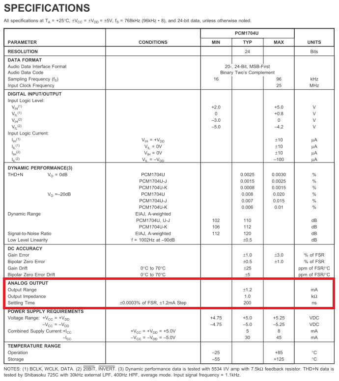

For PCM1704, the topology of R2R DAC is applied. So, the output impedance 1kohm is specified in PCM1704 datasheet.
For PCM1795, the output impedance isn't specified in PCM1795 datasheet because of the  difference between internal circuit topologies.
So, is my understanding correct ?

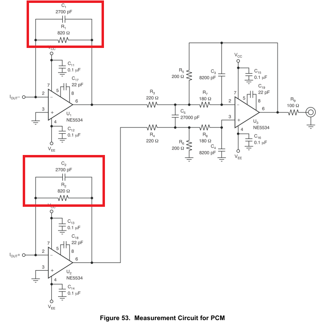

Additionally, For I/V converter, it is recommended to use 820Ω and 2700pF in PCM1795 datasheet. So, could you please tell us the  background why these constants are used?

    The resistor value in the I/V stage is select to try to optimize the gain of the circuit while avoiding the non-linearity region of the op amp output near the negative supply.  This circuit has the best noise performance by maximizing the gain of the first stage and minimizing the gain of the second stage (or even attenuating the output on the second stage).  See this cookbook article about that:
    http://www.ti.com/lit/an/sbaa333/sbaa333.pdf
    Otherwise, the capacitor value is selected to create a simple first-order filter to attenuate out-of-band noise and reduce the bandwidth of the TIA stage to ensure stability given that the second stage usually has a capacitive element near the output.
    This combination gives an fC of about 90kHz:
    Please let me know if that answers your question.
