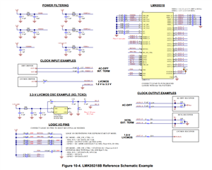

1. If there is EVM or Design file (Schematic, PCB) or Design guide, please let me know.

    1. Yes, we have an EVM user guide. Here is the link: LMK05318B EVM User Guide
    The EVM user guide has our EVMs schematic and layout that can be reference for your systems design.
    Figure 10-4 in the data sheet also shows the LMK05318B reference schematic design.
    I have also attached a how to build a LMK05318B schematic guide below as well.
    How to Build a Schematic for the LMK05318B.pdf

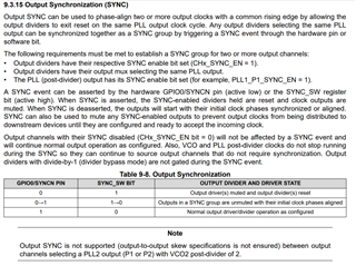

    3. The LMK05318B has an output synchronization feature that can be used to synchronize the phase of the output clocks. Section 9.3.15 in the data sheet provides an explanation of the output synchronization feature.
    In regards to aligning the phase of two devices, you would need to:
    a. First use the output synchronization feature to synchronize the output clocks of the first device.
    b. Then feed one of the outputs of the first device to the input of the second device and use the zero delay mode (ZDM) feature of the second device to synchronize the input clock with OUT7 of the second device.
    c. Then use the output synchronization feature of the second device to synchronize the phase of the second devices output clocks with OUT7 (thereby synchronizing the outputs of the second device with the input of the second device and thereby synchronizing the output clocks of the second device with the outputs of the first device).

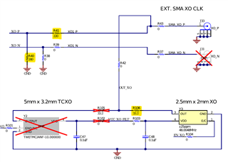

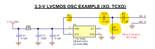

    Our customer will use oscillator for reference clock input.
    When I compared reference circuit of data sheet and EVM, there is some differences.
    Could you please let me know which circuit should I use?

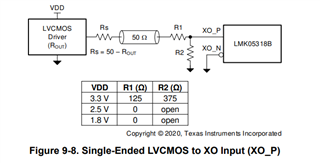

  • Hello Michael,
    For a single-ended XO input, the recommended termination is as follows:
    In the data sheet image, the capacitors are placed for an AC-coupled LVCMOS input, and the 100 ohm and 50 ohm resistors are used as a voltage divider to step down the swing of the OSC from 3.3 V to 1.1 V.
    In the EVM image, the 33 ohm is to match the 17 ohm output impedance of the OSC and the 220 ohm and 240 ohm are used as a voltage divider to step down the swing of the OSC from 3.3 V to 1.7 V.
    I would recommend using the termination shown in the image I have just shown at the beginning of this message.
