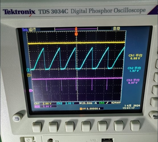

  • Dear Zach
    Customer recheck the waveform as your order, please check the following:
    ch1: VDD ch2: TRIG,ch3: OUTPUT
    Before remove R20
    After R20 removed:
    Is it what you want? any comment please let us know.

  • Hi Carols,
    Thanks for the further detail.
    From this result I can see the power supply voltage appears to be very stable at ~7V and the behavior does not appear to be related to the output loading of the 555 timer.
    I can also see that the output does pulse low at the end of the charging interval, when the TRIG pin reaches 2/3 of the supply voltage. This behavior was not visible in the previous waveforms.
    I am still unsure why the TRIG pin is discharging all the way to 0V, this pin should discharge to 1/3 of the supply voltage. It also stays low for a period of time before it begins charging again, which is also abnormal.
    One thing I notice is that the charging time is significantly different from the previous wave capture. See below, the previous scope showed about 50ms of charging time and now we can see less than 25ms of charging time.
    Can you provide any insight on why this charging time is different? Were there any changes to the test setup? What is the current limit setting on your power supply? Is the power supply approaching its current limit? If you leave the circuit on for an extended period of time, does the charge time change?
    Can you provide a clear photo of your entire board and test configuration including the connections? Please also include a close image of the DUT on the PCB.
    I see in your original post that an ABA test was performed. Can you describe in detail the steps of your ABA test and the results?
    Zach
