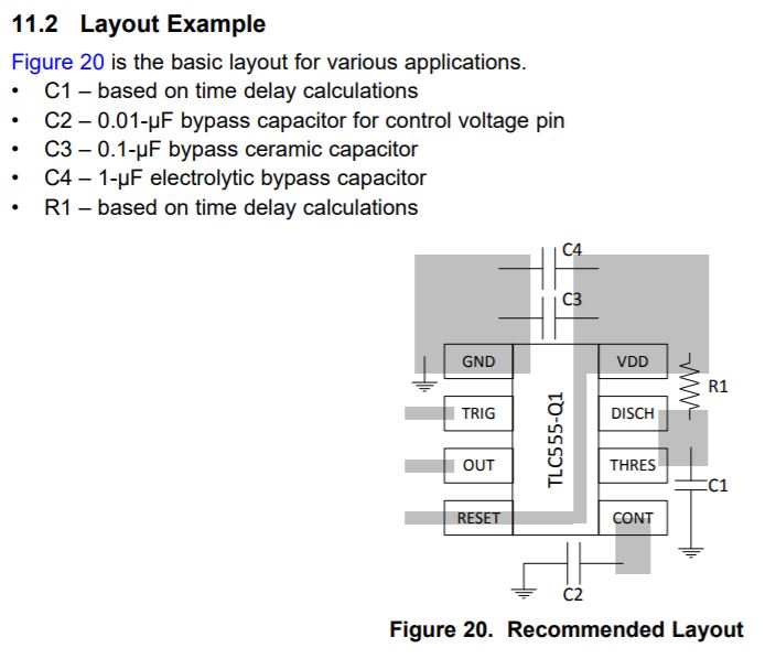

    Are the supply bypass capacitors and the control pin bypass capacitor placed close to the device as shown here?
    False triggers can be a result of noise events seen at the supply or control pin, or there could be something from your trigger circuitry around Q12 that is causing a false trigger.
