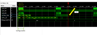

  • 1、The indicator in the manual is written as 5us, but it is not probabilistic during our use. What may be the specific reason.
    2、Adjustments have been made according to the previous suggestions, but there has been no improvement. Please refer to the waveform below
    3、1. Is the lock time written in the manual the worst or something else? Will there be a change in lock time during the repeated switching process, and how large is this change generally? What factors are related to this change?
    2. Can you provide a time when the PLL output frequency can be absolutely stable (non auxiliary and fully auxiliary)

  • Hi Zhang,
    That 5µs is a typical value when switching from 7500MHz to 1500MHz. This value will vary especially with temperature as temperature will affect analog PLL lock time. For the same reason, there is no absolute lock time for a PLL. If you want tight control to the switching time, maybe you should consider to use a DAC instead of PLL.
    From your timing diagram, the PLL is unlock after the second programming. Is this problem repeatable and always happen at the same frequency? If you increase the time interval between frequency switching, will this problem happen?
    Did you try using a smaller capacitor at pin 3?

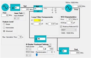

    For the loop filter, below configuration may return smaller PLL lock time.

  • Hi Zhang,
    PLL is an analog close loop system, as such, its performance is temperature dependent. Charge pump current, loop filter components (especially the capacitors), they all change with temperature. In addition, switching from H to L frequency or from L to H frequency, the response may also be different. In short, the lock time has no boundary. If you need very tight control to the lock time, use DAC.
    Your usage scenario is very aggressive, I cannot assure that LMX2594 or any other synthesizer can meet your requirement.
    The capacitor at pin 3 will affect internal LDO response, I was hopping that making this capacitor smaller can resolve your problem.
    The loop filter design is to help reduce the analog PLL lock time, giving you more margin meet your timing requirement.
