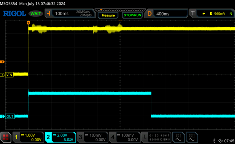

  • Hello Alex,
    When power is applied to the circuit the output of the LMC555 goes high as if it was triggered.
    VIN - Supply voltage being applied
    OUT - Output of the LMC555
    This behaviour seemed to be dependent on the batch/lot code of the devices - PCBs started working when the LMC555 chip was swapped for a different, potentially older batch code.

    Batch codes that didn't work:
    152R
    32H9
    It would be good to know what has changed and to know if there is a fix.

  • Hi Alex,
    Yes, we have replicated the issue across multiple devices within the same batch, we have tested over 60 boards which have exhibited this issue. We have come across another Batch Code that exhibits the issue: 32JC.
    Please find updated plots below:
    Monitoring pins 2,3,6,7,8:
    Monitoring pins 2,3,6,7,8, zoomed in:
    Monitoring pins 2,5,6,7,8:
    Monitoring pins 2,5,6,7,8, zoomed in:
    VIN was the +3.3V.PIC line, plots have been renamed.
    Owain

  • Hi Owain,
    There is no power on reset on the timer devices so the output will not be predictable during power up.
    Chris
  • Hi Chris,
    Does this mean that the datasheet has always been incorrect, or just the recent die changes have made it unreliable?
    The pin function table states that RESET_n should be connected to V+ to avoid false triggering, is this no longer the case?
    Should the datasheet be changed to state that power on reset circuitry is needed?
    We have procured 1000pcs of National Semiconductor LMC555CMM from May 2010 and they seem to work as our original design, and datasheet suggests.
    Owain
  • Hi Owain,
    The section you highlighted is correct. The reset pin is not related to power on reset. Power on reset circuits are used in designs to provide a known state on power up. The timers do not have power on reset circuits. The reset pin has never provided this feature and is only intended to operate with the expectation explained in the product datasheet when the device is fully powered on. Because there is no power on reset the output will be unknown when the device is powered on.
