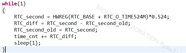

  • Hello Vadim,
    As you said, it looks like SYSTIM won't work "SYSTIM follows the RTC (Chapter 12) and can only be used in device active state" in this case.
    A thread about wakeup from standby with GPIO: https://e2e.ti.com/f/1/t/1322974/
    A RTC code snippet from the following thread about RTC https://e2e.ti.com/f/1/t/1353182/
    Alex F
