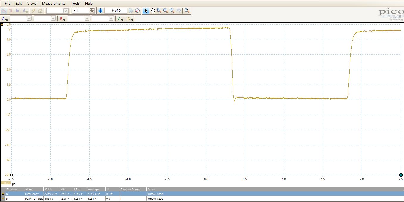

I try to make this timer circuit in bread board but i am not able to achieve the frequency. According to my calculation frequency comes around 1.2 MHZ . But i am able to achieve only 240 KHZ  in my bread board design. I am attaching the reference schematics . Astable mode in LMC555 Datasheet is different from what they have used here. Please help me to figure this out. One more this is that C306 - 4.7uF capacitor used is electrolytic one due to the unavailability of MLCC.

  • The values used are very close to the specified values in the schematics.  R308 = 4.4K ( 2 X 2.2K) , R309= 1.1K. and C307= 220Pf ( 4 x 56 pf in parallel). Checked all the wires and leads still the frequency is not improving. I have a reference brought out PCB board with same circuit, The only difference is that there they have used SOIC package IC. In that board the timer frequency is coming upto 725 Khz, but still not achieving the calculated value of 1.2MHz.
    I am attaching the output waveform obtained in my bread board design. I suspect some other problem other than connection issues.
  • Charles,
    In a perfect world your high time would be a short 183 ns and low time a long 643 ns. 1.2MHz 22% duty cycle.
