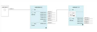

My question is somewhat related to my previous query:
https://e2e.ti.com/support/clock-timing-group/clock-and-timing/f/clock-timing-forum/1456461/lmk1c1104-generating-non-50-duty-cycles/5587416#5587416
In summary I am looking for clock generators that can give me a range of clock frequencies from 2GHz (LVPECL) down to 500k (LVCMOS). I used the clock tree architect to look for suitable ICs for this purpose and the tool recommended LMK03806 and LMK04821
I plan to buy the evaluation boards for both of these ICs to test out the functionality/capability.
I have a couple of questions:
1. Should I be using something like the clock design tool (or do hand calculations suggested in AN-1865) to validate the recommendations from the clock tree architect?
2. Can I use the USB2ANY dongle for programming my end use case? I plan to take inspiration from the user guide of the eval boards for schematics design and PCB layout. However, I would like to understand if there are gotchas when trying to program multiple payloads (the 2 clock generators above) on one serial bus driven by the USB2ANY dongle.
3. Once programmed, I assume that these clock generators above remember the settings in an EEPROM, or, will I need to plan for one on the final application?

  • Hi Pasoon,
    Clock tree architect is a good bet.
    If you can send your clock tree - me and Kadeem can take a long and to try and provide the best proposal that meets all your needs.
    We would need input freq, input type, required clk outputs & formats, etc.
    Your system requirements would also greatly help.
    Currently - there is no device with EEPROM that can generate the frequencies shown in the snippet which are: 200,30,15,10,5,100,2000,1000,500,250MHz
    In regard to the USB2ANY dongle - most our EVMs include this device for communication/programming.
    Please try to connect one USB2ANY at a time otherwise TICSpro can get a bit buggy.
    Some devices already have an MSP430 MCU on board and thus don't shit with the grey box USB2ANY dongle or in other words, they already have USB2ANY on board and simply require a USB cable.
    What I'm thinking we can utilize a device like LMK03318 which contains EEPROM to create most of the LVCMOS clocks and then we can input those clocks into another LMK03318 for the higher frequency outputs. Are those frequencies fixed or can they be adjusted?
    Vicente

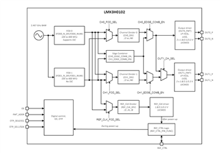

  • Hi Prasoon,
    It seems like LMK3H210x + LMK03318 is the best solution which meets your needs.
    They're a few requirements that are a bit difficult to implement though.
    Such as the fixed phase relationship between Input & Ouput but using a XTAL as source.
    LMK3H210x utilizes our BAW technology instead of requiring a ref clk.
    I have attached the block diagram of the two-output version.
    For your application a 4 or 8 output variant (sampling soon if i'm not wrong Kadeem/Cris pls correct me if i'm wrong) would be required.
    LMK3H210x utilizes one-time programmable (OTP) memory and LMK03318 uses EEPROM so you will not need to configure these devices upon every power cycle.
    The idea is for the LMK3H210x to create the LVMCOS clocks with a 200MHz FOD and the LMK03318 generating the higher frequency LVPECL clocks.
    I have added our clock gen AE in case you have configuration questions.
    Do you have any power consumption requirements or jitter requirements? Given you mention you drive transmission line test structures I would want to presume jitter isn't a cause for concern but rather drive strength or slew rate?
    Vicente

  • Hi Prasoon,
    I will let Cris or Kadeem comment on the exact date but it should be this year I think - don’t quote me though.
    TI needs to program OTP if you don’t desire to use the default configuration - which is the case for your application.
    You can use 2 LMK03318 but the issue now becomes you need an external ref clk, usually an XO to drive the first clk gen.
    LMK3H210x eliminates needing a third component since BAW is inside.
    Vicente
