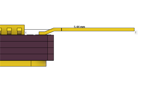

Dear Texas Instruments Support Team,
I hope you are doing well. I am currently preparing a PCB design that incorporates the LMX2615 in its Flight Model configuration. During the layout phase, I noticed that the only reference footprint example available in the LMX2615 datasheet corresponds to the Engineering Model (https://www.ti.com/lit/gpn/lmx2615-sp). To ensure compliance with the Flight Model’s mechanical and assembly requirements, I have created a custom footprint based on the package dimensions specified for the Flight Model variant.
Before proceeding to fabrication, Could you please confirm whether the created footprint fully reflects the Flight Model package dimensions?
