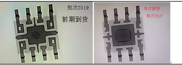

Please help confirm if there is a PCN for this change,Can the new batch of chips be used?
Hello Zhang Wei, welcome to the TI e2e forums.
Yes,
Yes, both are data sheet correct. They are not exactly the same
See this FAQ: [FAQ] TLC555: performance differences PCN 20231130002.1
