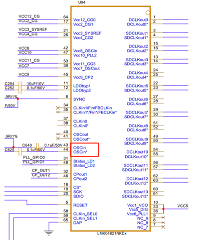

Hi Teams,
The customer now wants to achieve phase synchronization between the output clocks of LMK04828 between multiple boards, with phase always randomly changing. They have also referred to documents that can be found on the forum, but the clock architecture of their hardware may be slightly different and cannot be fully replicated; Can you provide us with some assistance?
This is their hardware architecture, with OSCin outputting a 125M clock.
The actual customer is currently using LMK04828B, which is only compatible on the schematic and has not been updated.
This is the register configuration used by the customer for single board multi-channel clock synchronization previously generated through software

Please help  take a look at this issue, thank you~
  • Hi Vayne,
    Can you share how you are phase synchronizing the LMK04828 outputs on the different boards? Based on your schematic, it appears your CLKin0 is unused, and could be better suited for a shared SYNC pulse across different boards (the pulse must arrive to both boards within the same 400ps window, based on your VCO frequency) - for more information, visit this link.
    Alternatively, if your boards have a common input reference, configuring the device in nested ZDM would allow for a much easier method of ensuring a shared phase determinism to the reference across the outputs of different boards. A SYNC event would still be necessary, but there is no time limitation since the outputs will all be aligned to the looped back output.
    Michael
  • Hi Michael,
    The 125M input is provided by another module on each board, and the modules are connected through a switch to ensure that the 125M reference clock input is from the same source and synchronized; Regarding the synchronization between multiple boards, the customer's solution is to send a pulse through the sync pin to achieve synchronization. The specific method is to send a trigger signal to both boards simultaneously through an external signal source. When this signal is detected by the FPGA, a enable is raised. During the effective period of the enable, when the 1pps signal sent by the 125M clock module is detected, the two signals will be synchronized with each other in the logic. The new signal after the phase is used as the synchronization event for 04828 in the multiple boards.
    They referred to the document you provided, and the customer now has the condition to send synchronization events to two board cards through sync pins at the same time (time accuracy should not reach ps level). The above also specifically describes the process of sending synchronization events through sync pins. In the second solution you provided, the customer seems to be able to achieve phase synchronization between multiple board cards (with relative phase remaining unchanged). They want to know the specific register configuration.thank you!
  • Hi Vayne,
    Attached is the register configuration (both as a .tcs and a .txt file) for single loop ZDM.
