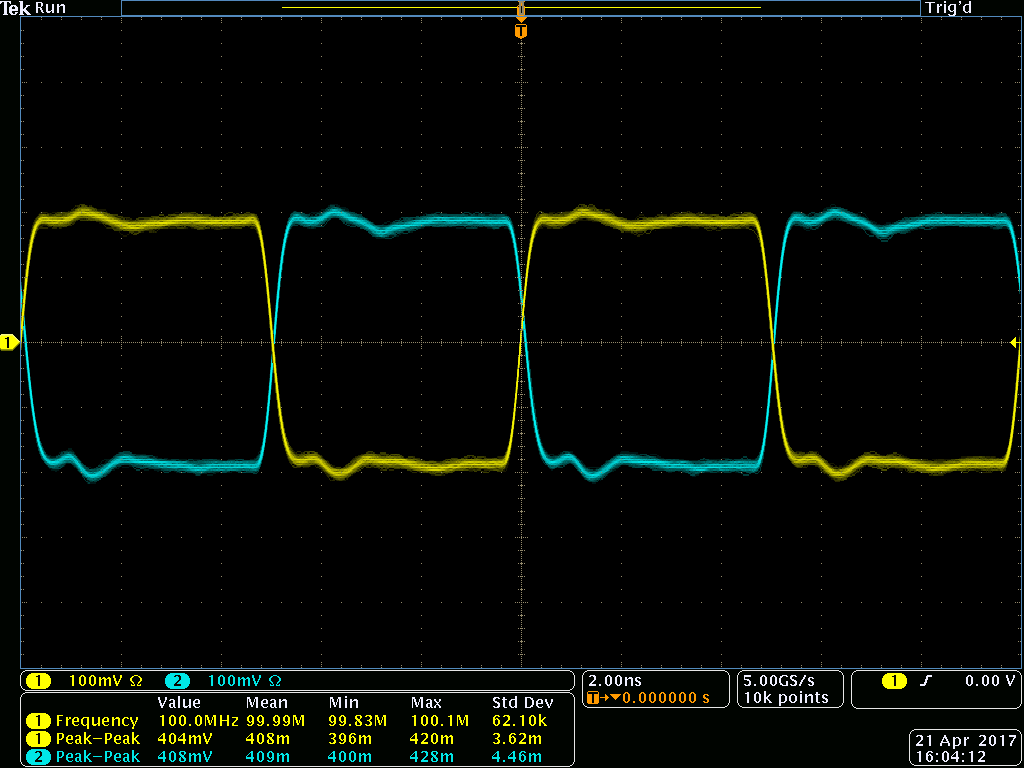

    I measured LVDS output with default configuration (termination after AC coupling)  in LMK00306EVM.
    The result as follows.
    It looks no problem.
    The common mode voltage of the LMK00306 output looks 1.2V.
    I think it is the proper DC bias point for the driver (LMK0030x).
    I think the description of the datasheet is wrong.
    Please reply it.
    Hiroshi Katsunaga
  • Hello Katsunaga-san,
    I apologize for the delay in our response.
    My understanding is that with the LMK00306 LVDS driver, to ensure a robust start-up when AC coupled, it is necessary to place 100 ohms with a DC connection to the output. This could be as illustrated in the figure above (figure 34 from datasheet) for devices with integrated terminations. Or it could be as figure 33 in datasheet which shows, LMK00306 LVDS driver --> Transmission Line --> 100 ohms ---> AC coupled --> Target device (with self bias) if the termination is not integrated. This would allow the driver to have 100 ohm DC load, without having two 100 ohm in the setup.
    My understanding is the datasheet is correct. I will confirm with others and see about making an update to the LMK0030x eval board instructions.
    Please refer to this E2E thread for more details: e2e.ti.com/.../526577
    73,
    Timothy
  • Hi Timothy,
    Thank you for your response.
    I understood your comments.
    However I think the figure 34 is too much idea for listing it in the D/S because this is not the issue in this device family but the issue in the LVDS interface.
    I think that this description loses an opportunity because it may cause misunderstanding.
    Thank you for your cooperation.
    Hiroshi Katsunaga
