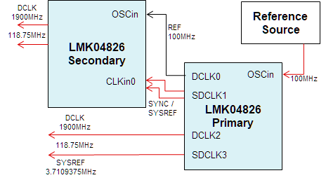

We are using three LMK04826B on our custom board. We are giving input of fixed 100 MHz to OSCin to three LMK's.
The following clocking scheme is implemented.
We are using VCO of 1900MHz and generate required clock for both FPGA and Dac38j84.
Dac clock     - 1900 MHz
Sysref          - 3.7109375 MHz
FPGA clock - 118.75MHz
In order to get clock and sysref aligned between multiple LMKs. We are generating a single pulse from FPGA and passing over sync pin of all the LMK's
1. Trace Lengths between FPGA -- LMK 1, FPGA  -- LMK 2, FPGA -- LMK 3 are not same.
By monitoring the SYNC pin of LMK 1 and LMK 2, the delay between the pulses is 120 ps. We are using SYNC_1_shot_EN.
When we are monitoring the LMK 1 and LMK 2 Sysref outputs, they are alligned with zero delay.
It is difficult to monitor 1900 MHz clock between LMK 1 and LMK 2, So we went for device clock of 475 MHz. At 475 MHz, Delay between LMK 1 and LMK 2 is 320 ps. It is same across multiple power cycles.
If Sysref are aligned perfectly, why there is delay at Device clocks ??
Is it required to maintain same Trace lengths between (SYNC pins -- FPGA ) for all LMK's ??
2. If they are not length matched, What is the minimum skew that LMKs can adjust to synchronize the outputs of different LMK's.
3. Is it required to give SYNC Synchronous to the LMK Input Clock ??
4. Same SYNC is used for all LMKS. If we toggle SYNC pin of LMK 1, at that point, LMK 1 Clock dividers will reset and clock will align with respect to rising edge of SYNC.
Now there is some Discontinuity in the OSCin Clock of LMK 3. So at the Same SYNC event, how clock outputs of LMK 3 will be aligned, since input to LMK 3 is not proper at SYNC event.
5. What happens if input to LMK is switched of for some short Duration. PLL comes out of lock. We will get output clocks with Jitter . What happens if we switch on Input again.
6. What are the alternates way to acheive Multi LMK synchronization for the given clocking scheme. (Any Solution with Zero Delay Mode ??)
7.We need alignment of DAC NCO.To do this we are doing NCO reset on Sysref. But we are unable to achieve it at 600 MHz NCO Frequency.
We are giving reset pulse to SYNC pin of LMK. From LMK we are routing this reset signal on to LMK Sysref Path. From this Path we are using this pulse to reset NCO.
Will there be any delay between the Sysref paths of two LMKs ??

  • Hi Pavan,
    The pictures didn't make it into the post, can you re-upload them if they're critical?
    I need to see the configurations and the SYNC procedure to understand the discrepancy. Possible reasons for differences include different _CNTH/_CNTL delay values between devices, SYNC edge getting retimed to different VCO cycles, device-to-device or channel-to-channel skew... since I don't have the configuration and I don't know your synchronization procedure beyond "toggle SYNC pin at all devices", I can't say for sure which one is responsible. But this sounds to me like the SYNC edge getting retimed to different VCO cycles.
    The skew adjustment usually happens at the outputs. The minimum adjustment is given by analog delay adjustment, which has a step size of 25ps on device clocks and 150ps on SYSREF. However, analog delay has some restrictions: cannot use analog delay above 1536MHz, delay step size can vary considerably over temperature (±half an analog delay step typically), and enabling analog delay can increase the noise floor. There is also the half-step digital delay adjustment, which can adjust by 1/(2 * VCO freq), or in your case 1/(2 * 1900MHz) = 263ps. The half-step and other digital delay adjustments will be highly consistent across temperature because they are fixed by the VCO frequency.
    Based on the block diagram in datasheet figure 13, the SYNC input is retimed to the VCO in normal mode or the SYSREF divider in re-clocked mode. Additionally, the retiming flipflops can be completely bypassed with CLKin0 as the SYNC source. If you need to precisely synchronize against the 1.9GHz VCO, bypassing the retiming flipflops through the CLKin0 input is likely the only viable option; the SYNC pin has somewhere between 3-5ns of setup time across PVT, so even if a SYNC pin pulse is received at the same time, there is no guarantee it will be received at the same VCO cycle.
    If the lock on the PLL is lost, there's no clearly defined SYNC behavior. You have to SYNC LMK3 after its input source is synchronized.
    If you take away the clock, the PLL will lose lock on the first invalid phase detector comparison. The N-divider will keep operating since the VCO is on, the R-divider will be halted; the phase detector will try to decrease the N-divider frequency, and the VCO will tend toward one of the rails at a rate determined by the loop bandwidth. For very short durations, removing the clock will introduce some brief frequency error before the PLL corrects and re-locks. For longer durations, removing the clock will eventually crash the VCO into the lower frequency range.
    With 100MHz and 3.7109375 MHz, GCD is 195.3125kHz. There isn't a great solution for PLL2 zero-delay mode in this case, unless you can handle <200kHz phase detector frequency (loop bandwidth must therefore be <2kHz, which is very challenging for PLL2). The only manageable zero-delay mode solution would be configuring PLL1-based zero-delay with the SYSREF divider as feedback, using a VCXO as the reference to PLL2, and synchronizing the outputs at the 195.3125kHz GCD frequency (corresponds to one GCD edge every 512 100MHz clock cycles). But it sounds like this could be a lot of work to reconfigure your setup for just this case. If the layout is like the previous question you asked on the LMK04826, you would need at least two VCXOs to achieve the desired zero-delay mode - the downstream device could receive a more favorable clock frequency directly.
    Without zero-delay mode, there's little hope of using the SYNC pin to reliably synchronize the devices due to the setup time of around 3-5ns. The SYSREF divider phase between devices would also be randomized, so retiming the SYNC pin to the SYSREF divider does not help. Unless you can use CLKin0 to provide SYNC pulses timed to individual VCO cycles, I don't see how else you could align everything precisely.
    Because the SYNC pin is retimed to the VCO in normal mode, there could be considerable delay difference between the two devices. If you could somehow guarantee that the SYSREF dividers between separate devices are in phase, you could retime the NCO reset pulse to the SYSREF divider. But for reasons described above, getting the SYSREF dividers to be synchronized in this specific use case is challenging. You could also use CLKin0 instead to drive the NCO reset pulse, bypassing all retiming flipflops and digital delay circuits, and the only difference in output timing would be propagation delay difference between devices.
    Two more general comments:
    1. I suggest you ask your DAC NCO questions on the DAC forum instead of the clocks and timing forum, to make sure the right team sees the questions. I'm on the clocking team, so I'm not sure about the DAC NCO details.
    2. If you can position all other LMKs downstream of LMK1, you only need to solve the synchronization problem once, for the first device. A common strategy is for the first device to use the SYSREF pulser to generate on-demand SYNC pulses which can be timed to individual VCO cycles, routed into CLKin0 of downstream devices. So if you can route your 100MHz oscillator through one root LMK for distribution to all other downstream devices, alongside a SYSREF output connected to each CLKin0, this can make it possible to achieve single-cycle VCO timing precision on all downstream devices.
  • Hi Derek
    Please find the attached Block Diagram and LMK04826 Configurations.
    We are not using Zero Delay Mode. We are using SYNC to reset the dividers.

  • Is there any alternative way to achieve Synchronization with my clocking Scheme ???
  • Pavan,
    Assuming you can't make changes to the connections as drawn in the diagram above, unless you put the devices in zero-delay mode at PLL2 Fpd = 195.3125kHz, retime the SYNC pin to the SYSREF divider, and manually keep track of the GCD in terms of 100MHz input cycles so you always synchronize to the correct phase, there is no other way to reliably synchronize the diagram as drawn through the SYNC pin - the setup time uncertainty is too large.
    If you can change the configuration of the block diagram so that one LMK04826 drives the CLKin0 port of the other LMK04826 devices, it's possible to use the first LMK04826 to drive the CLKin0 pins of the downstream LMK04826 for a precise timing synchronization. The approach would look more like this:
    By default, there's no guarantee that the output clocks will be consistently aligned to the root 100MHz clock between powerups, but all the outputs at the edge of the tree can be guaranteed to align with each other. If the primary LMK uses 100MHz SYSREF in zero-delay mode, you could further guarantee the output phase relationship to the input.
    A similar configuration exists for cascading devices, but there are more caveats: since the SYSREF frequency is also used from the root device, there is no way to guarantee the root 100MHz clock alignment to all the downstream clocks consistently. Regardless, it would still be possible to align every clock at the edge of the tree, including edge clocks that are derived from the primary LMK.
    We're having internal discussions with the SEM team about this application, and they may reach out to you in the near future with more detailed suggestions.
  • Hi Derek
    We are trying this scheme.
    Thank You
