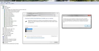

I try to follow this forum https://e2e.ti.com/support/data-converters-group/data-converters/f/data-converters-forum/672862/ads1298recgfe-pdk-firmware-not-found-retrying-dsp-not-ready. I found the libusb-win32 on github and install it with inf-wizard.exe. After this step, the driver setting is shown in picture 2 as requested in the forum.
However, when it goes to USB Styx driver, I select ADS129xECG-FE/lib_1298/Styx/usbstyx_drivers/installer/setup.exe. Installation is apparently ok. When I try to update the driver of the device with 2 locations (either he ADS129xECG-FE/driver/usbstyx.inf or ADS129xECG-FE/lib_1298/Styx/usbstyx_drivers/usbstyx.inf), I get an error message explaining that there is no compatible driver and that I should check if i could work with x64.
If the box "show compatible device" is not selected, nothing else appears. Moreover, as soon as I restart the computer or unplug/plug the board, the default driver MMB0 (NI-VISA) appears again by default.

    Something I just now noticed from the 3rd posted image. There are a bunch of system devices on your PC with driver issues (note the yellow triangles next to the WAN devices for example). Have you installed the latest drivers directly from ASUS for your machine?
