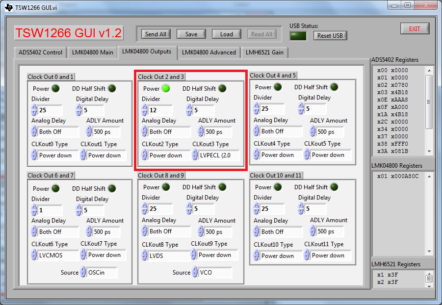

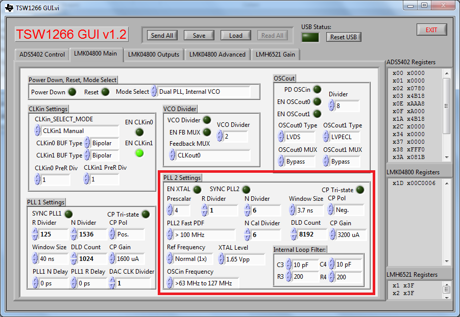

  • Hi Venky,
    I can answer for the TSW1266. I'm not sure which clock mode you're using (Single Loop, Dual Loop, etc), so I'll just show you what needs to change from your current setup. For the the TSW1266, simply set your LMK PLL2 settings as below to set the VCO frequency to 2949.12 MHz.
    And the clock output as a divider of 12 for 245.76 MHz out.
    If you want to use an external clock source, then you can simply load the "external_clock" configuration file that was included with the TSW1266 software.
    Matt Guibord
  • Hi Matt,
    Yes. This works and I see the PLL locked on TSW1266.
    I was using dual loop.
