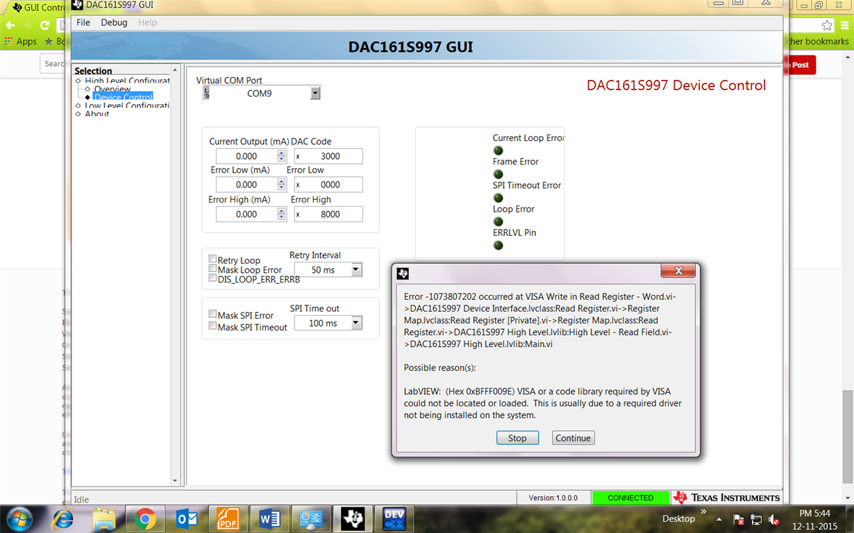

After connecting the DAC161S997EVM to a USB port and the Loop supply voltage, i run the DAC161S997 Software.But same error shown below is coming when any of registers is set for getting desired DAC output current. What may be the reason for this??

    This may be caused by not having NI-VISA installed on your system, or it may be conflicting with another VISA drive. Search for NI-VISA at the ni.com website and follow the instructions to install the driver.
