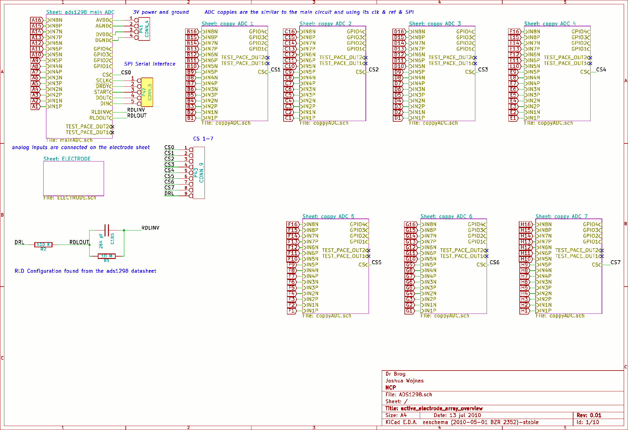

as a model to start and move further with a multi chip ads1298 design I would like to start a discussion with my open source schematics the files can be found on my site.
This is to document what is in the data sheet what I and others may have missed or what I misinterpreted.
Mostly it is to play nice & get where I want to be faster. So lets all work together. :)
Here is the overview shematic the more detailed ones will be below that are the boxes...
This is the main schematic with the ads1298 sorry they are big but I didn't want to clip any useful information.
here is the coppied shematic that are not the main one they are connected by the red global labels that means across all sheets they connect gold or yellow are herarchal lables eatch box is uneque on the top and the herarchal lables are good for specific pins....

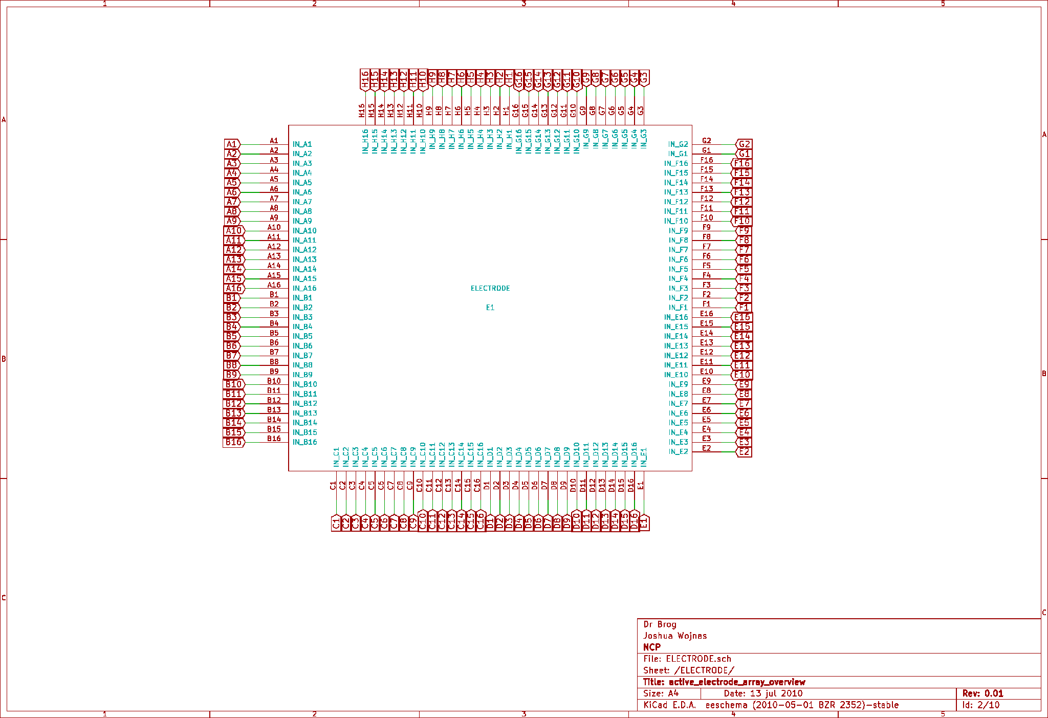

Lastly here is the modified BGA like connector for the silver electrode array that will act like a patch on the surface of the skin to take mesurements simultaniously and be able to watch the Evoked potentials and collect & catagorise signals.
here is the link to my website the code valt airea has the downloads for all the open source cad files using kicad that runs on many operating systems.
look at the date for the neweest version.
Opendous & I have a open source ads1298 design board & schematic if some engineers can look into the schematic and board and make some sugjestions the open source design should bring a lot of interest.
http://code.google.com/p/opendous/source/browse/trunk/Current_Designs/ADS1298/ADS1298_2Layer_Test
this is the google code airea
2043.ADS1298_2Layer_Test-Schematic.pdf
So if sugjestions and problems bugs etc could be looked for and posted that would help make a open source project better.
