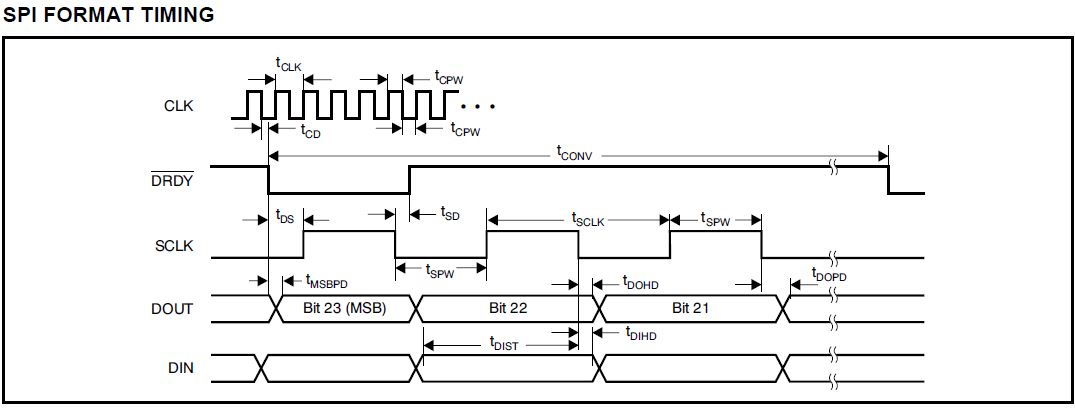

I am using MSP430F2916 to read ADS1278 from 3 wire SPI interface.  From Figure 16-4, page 442 of SLAU144J (msp430 family user guide), Should I set UCCKPH 0 and UCCKPL 1 to read data from ADS1278?
The datasheet of ADS1278 shows SCLK shifts out data on the falling edge.
Thanks, Jian

    You should be able to use the CPOL = 1, CPHA = 1 configuration in your MCU. Please confirm you are meeting the SPI timing specifications on page 8 of the ADS1278 datasheet, especially the setup/hold times (i.e. tDOHD).

    I am confused by the CPOL CPHA settings.  If CPOL=1, CPHA=1, (the fourth graph of figure 16-4 on page442 of SLAU144J.  The RX Sample Points are on the falling edge of SCLK(last graph of figure 16-4).  But ADS1278 shifts out data on the falling edge of SCLK.  I think the RX sample points should be on the rising edge of SCLK when no data is shifting out.   Correct me if I am wrong.
    Thanks, Jian

    I need to correct my previous post about the SCLK configuration for the ADS1278.
    You are correct that the ADS1278 shifts data out on the SCLK falling edge; therefore, the MCU should latch the data on the SCLK rising edge. However, the oversight on my part is that the ADS1278 shifts out the MSB following the falling edge of /DRDY. If SCLK begins with a falling edge, the device will shift another bit (MSB-1) and the MSB will be missed by the MCU. The correct configuration for this device is actually CPOL = 0, CPHA = 0 (MODE 0), where the rising edge occurs first and is used to latch the data. The MSB will be shifted out within 16ns (tMSBPD) of the /DRDY falling edge. The first rising edge of SCLK must occur at least one CLK period (tDS) after this /DRDY falling edge.
    Sorry for the confusion. Please let me know if you have additional questions.
