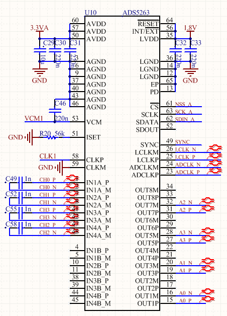

I have ADS5263 in my design,schematic as below:
CLKP is a single ended 12.5M 3.3V CMOS clock.
When I debugged the board, I found the ADCLK and LCLK is not related to CLKP.
The ADCLK and LCLK have the same output as I remove R45 and keep the CLKP Pin floating.
It seems the PLL in ADS5263 is not locked and behave like there is no CLKP input.

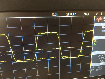

CLKP wave: 12.5MHz, 3.3V CMOS

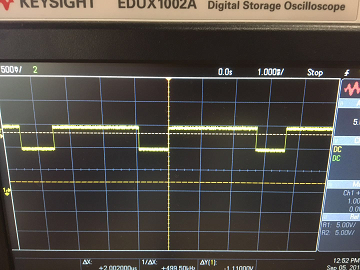

ADCLKP: about 300Hz clock, duty cycle is not stable

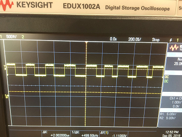

LLCKP: about 4kHz, duty cycle is not stable
