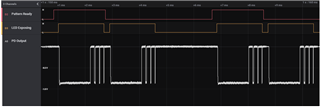

Hello, I am currently using the DLP4710EVM-LC to evaluate the DLPC3479/DLP4710 for an upcoming product, and I have a question on how the mirrors are modulated during the last 3 or 4 bits in either 7 or 8 bit internal pattern mode: is it possible to reduce the periods of time the mirrors are off in between these bit exposures?
Here is a scope capture of a photodiode's output when looking at an all-white 7-bit image being projected. Negative values here indicate detected light. The red arrows point to the "inter-bit dark periods" I'm asking about.
A key aspect of my use-case is to project a lot of light in a fixed amount of time -- we are working on a higher current LED drive, but the mirrors being off for so long reduces the amount of light we can project in a given timeframe by about 25%: in the image above, each off period is ~142 us, and the total exposure time projecting is 1,644 ms. This results in ~26% of the display time not having light projected (not including pre or post dark times or pattern set load times).
Is that inter-bit dark period configurable, or is there another tactic for increasing the percentage of time the DLP is projecting during an exposure?

This capture is for one complete frame, yes. In the image I provided above, it is projecting an all-white 8-bit 1-D image with an exposure time of 1,677 ms. Only the blue LED is used. This capture was taken using the EVM's GUI tool to continuously project images. Here is a capture showing several frames as well as the PATTERN_READY and TRIGGER_OUT_2 signals:
This same inter-bit dark time is present with 8-bit images, even at the maximum allowed exposure time of 4,168 ms:
Let me know if there's more information needed -- I can send Saleae captures as well if that's more useful.
