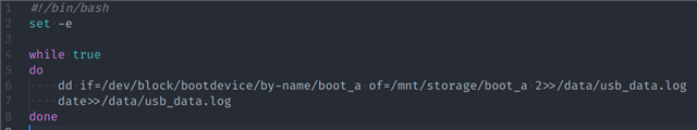

    The reset problem just occurs on USB3.0, when the system communicate with the USB storage device repeatedly read/write data. The problem could be reproduce by the following script:
    However, it has been found that this problem can easily recur on ELECOM USB disks, but other USB disks may recur when pushing stream files are saved for a long time.
    Through the software investigation, the reasons for locating the USB disk reset are as follows:

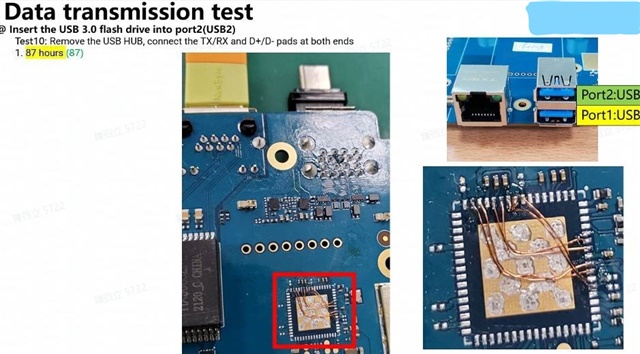

    Our customer have done some testing for the USB HUB, the result was shown in the following document.
    USB transmission interruption issue.pptx
    We use two ports of the HUB to connect two Type-A connectors. When inserting just one USB3.0 disk for data transmission with the system, the transmission will be interrupted due to unknown reasons after a period of time. However, this problem did not occur when inserting two USB3.0 disks at the same time and using one of them for data transmission.
    By the way, our customer also have conducted a test to remove the USB HUB by connecting TX/RX/D+/ D-pad to the jumper.  Currently, we are still running for 87 hours without any problems, which seems to be the problem of HUB.
    Our customer is also wondering if TI can provide the firmware for the pattern of USB3.0 HUB testing.
    Kind Regards
  • Hi Lumina,
    The TUSB80xx hubs do not have any firmware for testing.  Since using two downstream USB 3.0 devices simultaneously works, this is likely an issue with how the U1/U2 power states are being used not signal quality.  Can your customer try disabling USB 3.0 U1/U2 entry to confirm if that fixes the issue?

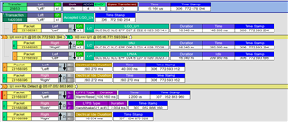

  • Hi, JMMN
    Can you get useful information from kernel logs and usbmon logs?
    We used the lecroy analyzer to record the error data, and Qualcomm analyzed it as follows:
    As per the lecroy logs, multiple Undefined Symbol  Sequence errors detected, which in your case is caused by bad signal integrity
    Suggest to tune hub usb signal integrity according to eye diagram report
    Do you have any suggestions for errors indicated by the analyzer? How do we tune the hub signal integrity?

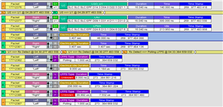

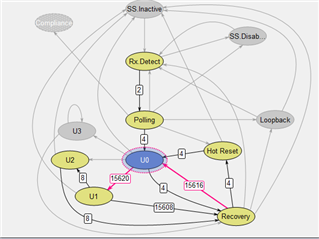

  • What is the difference between the files?
    In one case, the link enters U1 correctly but instead of exiting back to U0, the host sends a warm reset.  The hub would not generate a warm reset on a port unless the host sent it, I am not sure why this occurs?
    In the other case, the link enters U1 for 3+ seconds and then the link is disconnected.  It is difficult to determine what is happening without see the host to hub traffic, but the signal quality looks good (the USS packets are just artifacts of the Lecroy tool).
    I am very surprised that disabling U1/U2 didn't fix this issue, can you provide a trace with U1/U2 disabled?  Right now it looks like the host driver does not handle U1/U2 with hubs properly.
    JMMN
  • Hi, JMMN
    There is no difference between these two cases. They are two sets of identical tests. The only difference is that the ports used are different. Two TypeA are connected downstream of the hub, so there are two tests. What we observe is the same.
    From the software log, when transferring files, the kernel received an error code -71 (protocol error), and then reset the device. The warn reset in case 1 may be that the kernel has received a protocol error and then actively reset the device.
    So, I suspect that the error you pointed out may not be the first error, there may be more errors ahead, can you confirm it again?
    Our host controller has u1/u2 disabled by default, but I just noticed that the hub can also disable u1/u2 by configuring the hub's registers. Can the hub still enter u1/u2 when the host controller has disabled u1/u2? I don't know how to modify the registers of the hub, can you give me some advice, how to disable the u1/u2 of the hub?

  • Hello Xiaobo,
    Yes, the end result would be the same from both traces but the protocol looks a bit different, the trace that shows the warm reset doesn't show any errors before that just an entry to U1.  U1/U2 is definitely still enabled in this system.  The hub cannot initiate a U1/U2 entry unless the feature is enabled by the host and these protocol traces show that both U1 and U2 are enabled and in frequent use:
    If the customer cannot disable U1/U2 on the host, they can do it by setting register 05h in the hub.  This would require an EEPROM or I2C/SMBUS host be connected to the hub.  I would recommend just using a I2C host to set the bit for a test to verify that this fixes the issue.
