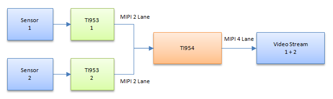

My customer found the MIPI data will be disappeared between 954 and ISP SoC, how to fix this issue? please advise some comments. Thanks!

  • Hi Sir,
    The answer as below:
    1) On how many systems are you seeing this issue? Is it easily reproducible?
    --> It is easily reproduction, the fail rate is around 10~30%.
    2) Provide the resolution, blanking, frame rate and data type from each Sensor.
    --> The sensor outputs 1280x720 30fps by MIPI 2 lanes.
    3) In which clocking mode are the SER and DES running? Is this Synchronous mode or non-Synchronous mode?
    --> We set dual sensor in synchronous mode.
    4) What is the External Clock value on the DES? And on the SER, if any?
    --> There is a 25MHz crystal on DES.
    5) What are the output settings of the DES? i.e. number of lanes, speed of lanes, type of port forwarding?
    --> 4 lanes output and 800MHz per lane.

    I have reviewed your configurations in the provided Word file, and here is my feedback. In many positions these settings make no sense!!

    7A 5D 78	;native I2C ID
    7A 65 7C	;Imager alias
    7A 6F 00	;0A	;BCC GPIO2 select frame sync signal – With setting this register to 00, you are sending the data from DES GPIO0 to the SER GPIO3, and sending the data from DES GPIO0 to the SER GPIO2
    7A 6E 00	;0A – With setting this register to 00, you are sending the data from DES GPIO0 to the SER GPIO1, and sending the data from DES GPIO0 to the SER GPIO0
    ;7A 70 6B	;RAW10 DT + VC0
    ;7A 71 6C	;RAW12 DT + VC1  not required, since you are not using DVP
    7A 72 55	;VC Mapping default - vc1 – confifure to 55 instead of FE
    ;7A 32 01	;reg 0x32 is reserved. Please do not write!!
    ;7A 33 03	;CSI Continous clock + 4 Lanes
    ;SL 2
    ;7A 20 00	;Forward all RX to CSI0 – Move out setting reg 0x33 and 0x20 till the end, after configuring the SER and the Image sensor.
    ;SL 2
    30 0E 90	;[7:4]: enable GPIO0/1/2/3 output – You are enabling only GPIO0 and 3 as outputs.
    ;30 0D 30	;enable FSIN remote control
    30 0D 10	;20 – You are enabling DES GPIO0 on local GPIO0 !!
    SL 2
    ;30 0D 38
    30 0D 18	;28 – You are enabling DES GPIO0 on local GPIO0, and setting local GPIO3 to 1 !!
    30 0B 20	;I2C speed: 390K
    30 0C 20
    30 02 53	;MIPI 2lane; 73: 4lane
    30 06 41	;43	;refclk to sensor:24MHz
    30 07 2A	;7D -  To avoid higher jitter on the generated CLKOUT, it is recommended to set reg 0x06 to 0x41, and reg 0x07 to 0x2A. But you will be getting CLKOUT of 23.81MHz instead of 24MHz
    32 0E 90	;[7:4]: enable GPIO0/1/2/3 output
    ;32 0D 30	;enable FSIN remote control
    32 0D 10	;20
    SL 2
    ;32 0D 38
    32 0D 18	;28
    32 0B 20	;I2C speed: 390K
    32 0C 20
    32 02 53	;MIPI 2lane; 73: 4lane
    32 06 41	;43	;refclk to sensor:24MHz
    32 07 2A	;7D  These are repeated settings!!
  • Hello Henry,
    In my last review for your script, I have provided some corrections and comments indicating wrong settings. In your latest script I can see same errors are still present! It looks like you have just copied my comments without correcting the errors I have pointed out!
    Please read all my comments on the script review and correct all these errors!
  • Hi Sir,
    OK, the customer will re-check the settings again, may I send the Gerber files to you go through the private e-mail address?
  • Please let them try changing the settings as suggested. If that does not help, then you can send me the layout for review.
