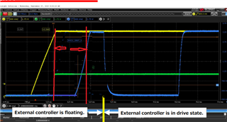

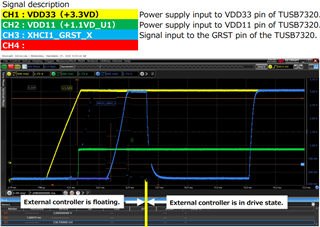

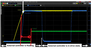

I would like to confirm something.
1.
Please check the power supply startup of 3.3V and 1.1V.
Could you please comment on this waveform?
The point of concern is that 1.1V has started up first, but 3.3V has started to rise first.
