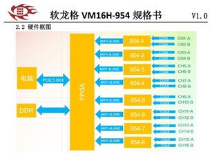

The setup we are using is image sensor of OmniVision OV10642 connected to DS90UB953 and DS90UB954.
The connection between the components is coax cable.
We defined a list of tests to the manufacturer to perform after the assembly and we meet few issues.

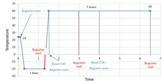

The problematic test is high & low temperature.
We defined the temperature and time according the picture below:
At each "red" point defined to read a list of few registers to check if there are errors.

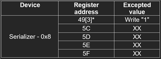

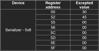

The registers list we defined to read:

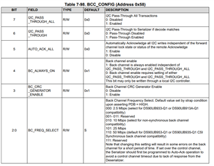

I defined them to clear the registers after each reset or power up to reset the errors can occur at the initialization stage:

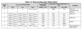

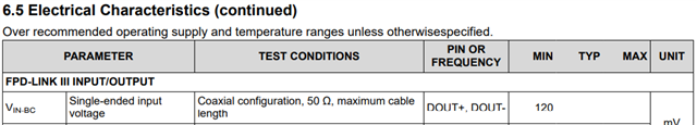

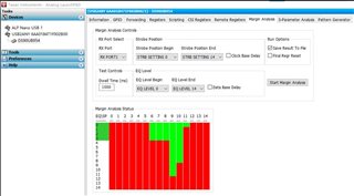

The problems we saw are in register 0x52=47, 0x55 & 0x56, and 0x5C=01 on the Serializer side.
Another issue is that one camera can pass the test and if we ran the test again it can be failed.
The errors can appear also at room temperature..
What could be the reason to those errors, and how can we solve them?
Just to clarify that the functionality of cameras failed theses tests are OK, and we didn’t saw issues in the field. (Yet)
We must understand if that is an issue at all, and why we are facing it.

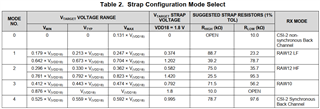

I attached a list I got from the manufacturer of all the registers from "faulty" camera module.(NG Camera module data.txt)

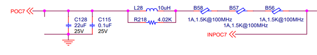

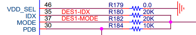

Also attached the schematics of camera module and the test equipment they use on the production.

    1. Based on the register reads shared it appears that there's consistently BC CRC errors (shown in 0x52[1], 0x55, and 0x56). Have we checked the insertion loss / return loss for the link in question? This would include both PCB and the cable.
    2. In the ECU schematic there are 4 deserializers, are issues seen on each FPD-Link?
    3. Are each of these FPD RX ports paired with the same serializer in application?
    4. Have we also monitored register 0x4D /  0x4D of each deserializer port to check RX link status while this issue is observed?
    Thomas

    1. The manufacturer ran the MAP tool on the boards.
    Here is the result:
    According to TI documents the result of the MAP tool looks OK..

    Just updating that in the schematics of the Deserializers appears capacitors of 0.1uF on the RINx+ and 47nF for the RINx-.
    I asked them to replace the capacitors to be the same as we have on the camera module, 33nF on the DOUTP and 15nF for the DOUTN.
    3. Yes.
    Actually, the board with the Deserializers is the test equipment in the production line.
    They connect 16 cameras in parallel and check the registers of Serializer.
    Block diagram of the test equipment:

  • Hi Itay,
    Thanks for following up with additional info here. Please see my feedback below:
    1. The MAP result here is helpful, but this is primarily showing the forward channel link margin rather than possible back channel signal integrity issues. If there's any data available on return loss could we take a look?
    2. How many systems do we see this issue on? As you mentioned a good experiment would be to swap out the AC coupling capacitors to ensure that they match between the SER & DES.

  • Hi
    1. We didn't measure insertion loss on our system.
        Do you have any tool like the MAP tool to measure it?

    • Could you clarify the desired mode of operation on the UB954? Based on the deserializer strap it appears that we're targeting CSI-2 sync mode from the schematics provided, however mode strap targets raw10.
    • For the deserializer board, I saw on page 6 there are PoC networks for each port. Are these with the same OPN as the serializer PoC network?
    Thomas
  • Hi Thomas
    • I have not received yet the registers dump of Deserializer.
    • Attached the script they use, Wissen_fisheye_setting.txt
    • I see that they connected 20KOhm to VCC1V8-DESx, and in data sheet there is no such option at all..
      Anyway, pull up resistor defined the Deserializer to work as RAW10 mode, and our camera module working with MIPI CSI-2 synchronous Mode.
    • Yes
      i asked them to replace a few components..

    The resistor of 20KOhm connected to 1.8V on the MODE pin is OK?
  • Hi Itay,
    The 20k pull up resistor connected to the mode pin should target mode 3 of the deserializer (raw10 mode) as the node will be at 1.8V.
    One question from my side, I saw we were pairing with the 953 in mipi csi-2 sync mode. Do you know why we have selected this mode on the deserializer? Normally we would see the UB954 set to CSI-2 sync back channel to match the mode setting of the ser.
    Thomas
  • Hi
    I asked the manufacturer about the mode pin, They are using MUX to chose operation mode with GPIOs from FPGA:
    What is the difference between those 2 modes?
    If i remember correctly, its because we get the clock of the Ser from the Des, am i right?
  • Hi Itay,
    in this case as we’re pairing 954 with 953 in csi sync mode both devices should match this mode.
    best,
    Thomas

  • Hi Itay,
    This is a coax application correct? So the DOUTN should be terminated here? The spec that I'm looking to confirm we're meeting is the Vin-BC.
    Thomas
  • Hi
    Yes, we are using coax application.
    I connected the negative probe through 50Ohm resistor to GND, Its correct or you want to solder DOUTN to GND through 50Ohm resistor?
    PDB pin is low in the picture below.
    Its look similar to the previous picture.
    Best

    I went through the Wissen_fisheye_setting.txt file and there is no write to 0x49 to clear the CRC errors. Is this being done separately?
  • Hi
    I defined to wrote 1 in register 0x49[3] at the beginning of the test.
  • Hi Itay,
    Understood, just wanted to clarify it was not in the config file. Since error clearing is being done intermittently, I don't think this would be the source of the issue.
