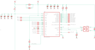

I'm encountering an issue while interfacing the DP83826 with my STM32H74 using LWIP.
  • I'm operating in RMII basic mode,
  • and while some boards with identical software (web server, TCP, UDP, etc.) are functioning correctly, many are facing the same problem.
  • I'm observing incoming RX signals during ARP with my PC's IP and MAC addresses in debug mode. However, I'm only sporadically seeing signals in TX_D0 and TX_EN.
  • I've confirmed that the MDIO and MDC signals are functioning correctly based on register readings. Additionally, soldering appears to be fine.
  • The output clock frequency 50MHz ok (derived from a 25MHz input), and the link is established.
  • No ARP or IP request on wireshark from the board
Could you please assist me in debugging this issue? rx then tx
Also, I'm wondering if there's a way to test the PHY layer, perhaps through a loopback test? If so, which loopback method would you recommend?

  • Hi Louis,
    Thanks for your query!
    The setups are all identical in HW, SW, and application setup (IP/MAC address)?
    Do you see any difference in the PHY register dumps between the working and failing setups?
    For loopback on the PHY's MDI side, write register 0x16[4:0] = 10h (reverse loopback) .
    For loopback on the PHY's MAC side, write register 0x0[14] = 1h (MII loopback) .
    Evan
  • Evan Thank you for your answer ,
    The setups are all identical in HW, SW, and application setup (IP/MAC address)? Yes
    Do you see any difference in the PHY register dumps between the working and failing setups? No all are the same
    For loopback on the PHY's MDI side, write register 0x16[4:0] = 10h (reverse loopback) . ?
    Could you clarify what I should expect when enabling loopback? Is it necessary to connect a cable to a partner device?
    I'm always facing this problem. Could you provide some other solution please?
  • Hi Louis,
    This is strange, I expect some link down or some other status bit difference between working/failing setups.
    Clarifying on the loopback tests:
    For MII loopback, no link partner is required. After setting loopback, send data from DP83826's MAC and check if the same packets are received to validate the MAC-side connection.
    For reverse loopback, link partner is required. After setting loopback, send data from STM32H4's MAC and check if either the STM32H74 or its MAC receives the same signals looped back from DP83826.
    Please also test with this register script on DP83826, there are some configs here that may help with IOPT consistency:
    DP83826_IOPT_Script.txt
    Thank you,
    Evan
