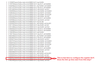

  • Hello Melissa,
    I got the link up time test report.
    Below questions, could you help to confirm again?
    1. The DUT’s PHY configuration must be finished within 20ms after reset.  Do you give us the configuration document?
    2. DUT shall wait until the PHY indicates an active link and stop timer t0.  How to get the info that PHY indicates an active link?  Read the register 0x001[2]?
    Best Regards!

  • Hello Melissa,
    Now, we are testing the link up time. But the test result is more than 100ms.
    We recorded the link up time is from reset release to reading the register 0x001[2].
    We test the link partner :  master is DP83TC814SRHARQ1 and the slave is DP83TC814SRHARQ1.
    So we want to know TI using which signal as the indication an active link.
    Best Regards!

  • Hello Melissa,
    • Are you measuring link up time on your custom board?
      --> Yes. We are measuring link up time on our board.
    • Are you using our linux or RTOS driver? (https://github.com/TexasInstruments/ti-ethernet-software/tree/main )
      --> Our SW team is confirming.
    •  (2) LED and TRD_P/TRD_M waveforms
    • From the waveforms you provided, the link up time is <100ms on the TI EVMs.
      --->It has two red box, it means that it has twice link. Does TI use the time that RESET signal high to the first red box for link up time?
            If it measures to the second red box time, it also is more than 100ms.
    1. There is some latency and delay in reading 0x001[2], I don't believe this will work. I will need to check how this is measured and get back to you by the end of the week.
    --> Could you give us the confirm result that how this is measured?
    2. About the test report, it has some questions, please help to confirm:
    2-1) About the Step 1, does the soft/hard reset mean the register 0x1F[15-14]? Or the pin 3 RESET_N?
    2-2) About the Step 3, the t0 is after finished configuration. Doesn't the link up time include the time spent on configuration?
    Best Regards!
  • Hi Jingkun,
    It seems like the 814s on your custom board is linking up within the correct time. I do not see a problem here from the waveforms you provided.
    The linkup time is only the 2nd red box, not the 1st red box.
    C&S (official test house) uses register 0x133. However, they some advanced automated setup that measures this with only a microsecond delay. It is hard to replicate. We typically measure at TI by looking at the TRD_P and TRD_M waveforms which provide a good estimate.
    Hard reset is 0x1F=0x8000
    Soft reset is 0x1F=0x4000
    For T0, they start the timer after reset in the software and stop the timer after config is done. The requirement for this is 20ms. However, C&S has a advanced automated setup with microsecond delay to measure. It is hard to replicate.
    The passing report we forwarded to you shows we have already passed this spec before, since we have passed IOP21. The config time is unrelated to the link partner.
    Melissa
  • Hello Melissa,
    --> The time is about 556ms from Pin_3(RESET_N) high to the 2nd red box. It has exceeded 100ms.
    So we don't know the resetting PHY means that Pin_3 (RESET_N) changes from low to high, or it means resetting the register.
    If the reset PHY means Pin_3 (RESET_N) changes from low to high, the link up time of demo also exceeded the SPEC requirement.
    Are you base in China? If yes, could you have a talk via phone?
    Below is my phone number:18030086702.
    Best Regards!
  • Hi Jingkun,
    Can you confirm what driver is being used and provide the driver file aswell?
    It seems there has been some confusion, I was talking about this image where I have drawn red boxes, not the one you've showed above:
    The link up time in this green waveform is the 2nd red box.
    In the new image below, the link up time is the yellow box I have drawn below.
    On our EVM it should be measured from the register write, not the pin. For future reference hard reset is 0x1F=0x8000 and soft reset is 0x1F=0x4000.
    For your board, I need to confirm in the software driver what register writes are being done after reset.
    If there is still some confusion we can setup a meeting, please reach out to your local Field Representative to set this up. I am based in the PST Time Zone.
    Melissa
  • Hello Melissa:
    --> Sorry, I used the wrong picture. Below is demo test result:
    --> It means that the link up time is from register 0x1F=0x8000 or 0x1F=0x4000 to 0x133[12] =1.  Is it right?
    Best Regards!

  • Hello Melissa,
    Below is configuration list after Pin_3(RESET_N)=High:
    [    3.190587] jason3:phy_read_mmd MMD=0x1f, reg=0x45d
    [    3.190725] jason3:phy_write_mmd MMD=0x1f, reg=0x1f, val=0x8000
    [    3.526956] jason3:phy_write_mmd MMD=0x1, reg=0x834, val=0x8001
    [    3.527107] jason3:phy_write_mmd MMD=0x1f, reg=0x1f, val=0x8000
    [    3.527243] jason3:phy_write_mmd MMD=0x1f, reg=0x523, val=0x1
    [    3.528494] jason3:phy_write_mmd MMD=0x1f, reg=0x834, val=0x8001
    [    3.528636] jason3:phy_write_mmd MMD=0x1f, reg=0x873, val=0x821
    [    3.529151] jason3:phy_write_mmd MMD=0x1f, reg=0x896, val=0x22ff
    [    3.529292] jason3:phy_write_mmd MMD=0x1f, reg=0x89e, val=0x0
    [    3.529428] jason3:phy_write_mmd MMD=0x1f, reg=0x1f, val=0x4000
    [    3.529946] jason3:phy_write_mmd MMD=0x1f, reg=0x523, val=0x0
    [    3.530088] jason3:phy_read_mmd MMD=0x1f, reg=0x18b
    [    3.530960] jason3:phy_write_mmd MMD=0x1, reg=0x834, val=0xc001
    [    3.531102] jason3:phy_write_mmd MMD=0x1f, reg=0x45f, val=0xf
    [    3.531238] jason3:phy_write_mmd MMD=0x1f, reg=0x453, val=0x3
    [    3.543353] jason3:phy_write_mmd MMD=0x1f, reg=0x1f, val=0x4000
    [    3.739900] jason3:phy_write_mmd MMD=0x1f, reg=0x1f, val=0x8000
    [    3.740038] jason3:phy_read_mmd MMD=0x1f, reg=0x45d
    [    3.740176] jason3:phy_write_mmd MMD=0x1f, reg=0x1f, val=0x8000
    [    3.852328] jason3:phy_write_mmd MMD=0x1, reg=0x834, val=0x8001
    [    3.852465] jason3:phy_write_mmd MMD=0x1f, reg=0x1f, val=0x8000
    [    3.852601] jason3:phy_write_mmd MMD=0x1f, reg=0x523, val=0x1
    [    3.852737] jason3:phy_write_mmd MMD=0x1f, reg=0x834, val=0x8001
    [    3.852873] jason3:phy_write_mmd MMD=0x1f, reg=0x873, val=0x821
    [    3.853009] jason3:phy_write_mmd MMD=0x1f, reg=0x896, val=0x22ff
    [    3.853145] jason3:phy_write_mmd MMD=0x1f, reg=0x89e, val=0x0
    [    3.853281] jason3:phy_write_mmd MMD=0x1f, reg=0x1f, val=0x4000
    [    3.853417] jason3:phy_write_mmd MMD=0x1f, reg=0x523, val=0x0
    [    3.853554] jason3:phy_read_mmd MMD=0x1f, reg=0x18b
    [    3.853690] jason3:phy_write_mmd MMD=0x1, reg=0x834, val=0xc001
    [    3.853826] jason3:phy_write_mmd MMD=0x1f, reg=0x45f, val=0xf
    [    3.853972] jason3:phy_write_mmd MMD=0x1f, reg=0x453, val=0x3
    [    3.864762] jason3:phy_write_mmd MMD=0x1f, reg=0x1f, val=0x4000
    [    3.982394] jason3:phy_write_mmd MMD=0x1f, reg=0x602, val=0x0
    Best Regards!
  • Hi Jingkun,
    Yes, linkup would start from the last step.
    Melissa

    Best Regards!
  • Hi Jingkun,
    Thanks for providing this code. It looks like you are using the most updated driver on our website so the PHY is being configured correctly.
    2.Could you explain the difference of Pin_3(RESET_N),  0x1f[15] Software Global Reset(Hardware reset) and the 0x1f[14] Digital Rest (Software Restart) ?
    0x1F=0x4000 Will reset the PHY but keep the registers the same
    0x1F=0x8000 Will reset the PHY but refresh the registers to the default values at power up.
    3.Are the functions of Pin_3 (RESET_N) and 0x1f[15] Software Global Reset (Hardware reset) exactly the same?
    0x1F=0x8000 Will reset the PHY and refresh the registers.
    RESET_N will reset the PHY, refresh the registers, and resample the straps for Autonomous/Managed, Master/Slave, RGMII/SGMII/etc.. modes.
    4.Can we cancel the control of Pin_3 (RESET_N)?
    RESET is active low, so if you want to you can keep it HIGH all the time. You will just not be able to reset the PHY using RESET_N as described above. You will have to turn off the PHY and restart the power up sequence if you want to resample the straps.
    Melissa
