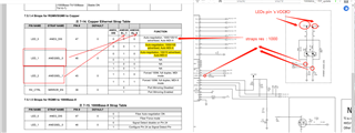

2. We read the datasheet, the LED1 IS 2-Level strap configuration, the TARGETVOL Vmin=0.5VDDIO, Vmax=0.88VDDIO when the MODE1;
   The PD=9Kohm based on the datasheet 7.5.1.2,
   We Calculated the LED1 voltage as below:(The LED resistors Series with 470ohm and Resistors in Parallel with 2.49Kohm, the LED conduction resistance consider to 100ohm),
   Vled1= (9K/(470ohm+100ohm)//2.49Kohm+9K)*VDD=0.95VDD, 0.95VDD is morn than 0.88VDD, please kindly provide the principle of this design;

    1) This is a typo, DP83869 supports 1000Base-T, not TX. Apologies for the confusion here.
    2) Please assume higher series resistance for the LED in this example (1kohm).The strap values can be changed as needed depending on LED used.

    For item#2) We also has the issue for the LED current because the VDDIO is support the 3.3V/ 2.5V/ 1.8V, based on our count, the voltage of the LED is very small because the 1Kohm divider resistor when the VDDIO is 1.8V/ 2.5V, we afraid the brightness of LED is very weak, so if there are any other suggest to make sure the 0.5 x VDDIO< Vtype <  0.88 x VDDIO, or we need to use the VDDIO=3.3V?

    Smaller series resistance LED can be used if LED brightness is a concern.
    For the LED chosen, please refer to Table 8-9 to calculate appropriate strap resistor values to ensure good margin between the VDDIO threshold for the mode chosen.

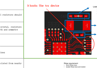

    What is the purpose of U6/U13? We typically discourage active components on MDI lines aside from magnetics, is this required for your system?
    These are the TVS device, we refer to the PHY tomagnetics and SNLRO48A layout guidelines, please advise if we can add the TVS on this design?
    This is acceptable, thanks for confirming.
    For the trace of EXT_CLK  length, see the layout picture, it's only about 120mil(trace A + trace B)
    Layout looks good here.

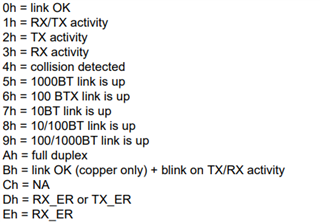

    This condition is unclear to me. Does the desired interrupt condition fall within any condition listed below (register 0x18):

    and how to get the right information from the LED on/off when only the 10Base or 100Base working condition? Thanks.
    Please refer to register 0x18h. The LEDs can be configured to turn on for a specific link speed state.
