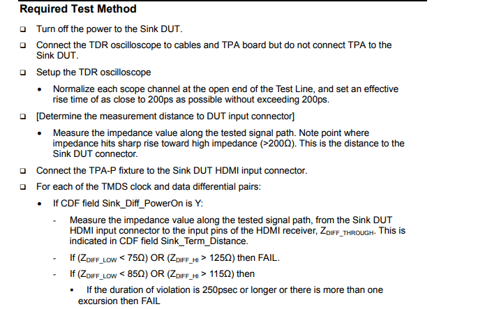

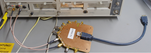

  • TID8-8 & HF2-4 = FAIL
    The Impedance test items TID8-8 & HF2-4 show a Fail in the red-boxed sections(The violation lasted for more than 250 ps). The CTS explanation is as follows:
    Impedance_TID8-8:
    CLK
    The data lanes look very similar as the picture above.
    The same for the HF2-4

    For TID8-8 & HF2-4 (Impedance Test)
    • They can use an ESD with a lower line capacitance to see if the duration below 85ohm will be shorten to lesser than 250ps. We will also need to see their layout to see if other passive components are contributing to the differential impedance < 85ohm. Do they have a passive TDR measurement on their HDMI input with the bare board?
    We have made TDR measurements with and without ESD safety diodes. Below you can see the measurement setup, the top-view part of the PCB with the HDMI-connector, the ESD safety Diodes and the TMDS181, as well as the measurement results, with diodes in (pink line R2) and diodes out (blue line R1).
    When you compare the pink and blue lines, you can see that there is no difference in the impedance till the position of the ESD diodes. The red line is the position of the HDMI connector, while the line with the red arrow is the position where the ESD diodes will be located. I assume that the second drop down to below 80 Ohm on the pink line, will be the TMDS181 device.
    When we remove the ESD diodes, we have the hope, that the drop below 85Ohm will not be longer than 250ps, which is in our measurement the case. But I do not know if IST will get exactly the same measurement results as we did...
    Can they ask IST to perform the active TDR without the ESD diode? Below is the active TDR we took on TMDS181, the excursion below the 85ohm is around 45ps.
    No, this is not possible. We have to send them a new Monitor with a modified electronic input board. Which costs us time and money. Since we have so many issues, we are currently thinking about a redesign with another Re-Driver / Re-Timer chip...
    In parallel we are also in discussion with our FPGA vendor, in order to find a solution for this issue...
    By the way, the TMDS181 datasheet tells me, that input impedance for the differential TMDS signals can range from 85Ohm - 115 Ohm, which are already the first limits, defined in the Compliance Test. Sounds to me a bit risky to use this chip?
    Requirements Compliance Test:
    The 85ohm is the minimum input differential termination impedance, majority of device will have the typical 100ohm differential input impedance.
